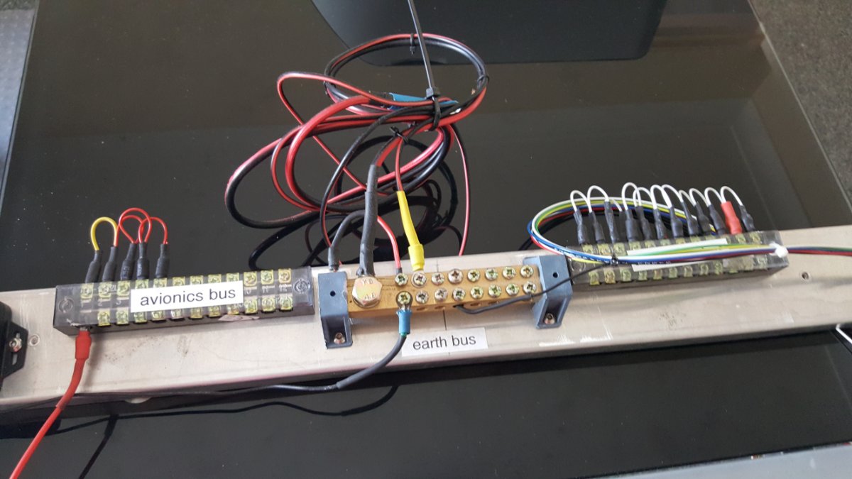

  1. My main earth block is direct to battery, also will do ground to frame ,but all switches will now go to ground block as will all lights, gauges, actuators plus will ground to frame
  2. Bus for power to accessories just looped to each contact only using 5
  3. Here is my bus for ground and power thoughts? Thanks for your replies
  4. using Tefzel wire sizing for each component mostly 20 22 g 1 overload switch is for battery isolator ,this feeds the on off switch to the bus ,using 1x40 amp 3x10 amp,4x5 amp overload switches i can change these if required,my dash hinges back so i can access all electrical components, also access hatch 300x200 behind the fire wall
  5. Where would i get a bus comb from ,looking at ebay mostly from US and COSTLY cheers gareth
  6. Each switch is per single use other than 2 usb and strobes, radios tx, ems ,flaps, trim,etc all single use cheers Gareth
  7. Here is my bus for ground and power thoughts? Thanks for your replies
  8. Thanks rfguy thats what i thought but asking someone who knows is better than taking a stab in the dark cheers Gareth
  9. I have 8 carling rocker switches with power coming through 8 thermal overload contacts, all switches require led grounding plus grounding for load, can i loop all switches with grounding for led and load or should i go for individual grounding to terminal ground block Cheers Gareth
  10. To the avionics guru,s out there ,i have 8 panel switches powering from 8 thermal overload switches, can you loop ground to all switches and have 1 main ground to ground block or individual grounds to block Thanks gareth
