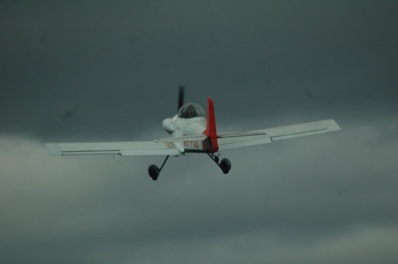

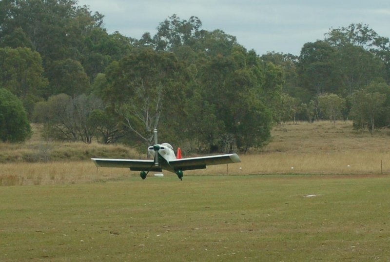

Yenn Posted July 22, 2013 Author Share Posted July 22, 2013 I am not too good at this, trying to upload a couple of pics. Hope they appear. 7 Link to post Share on other sites
Yenn Posted July 22, 2013 Author Share Posted July 22, 2013 This is the second attempt to upload a couple of pics. I thought the first attempt failed. 3 Link to post Share on other sites
sfGnome Posted July 22, 2013 Share Posted July 22, 2013 Noice! I'm trying to work out from the second photo whether the rego is VH-FOO or VH-POO. Link to post Share on other sites
Yenn Posted July 23, 2013 Author Share Posted July 23, 2013 FOU r for 4 Link to post Share on other sites

metalman Posted July 24, 2013 Share Posted July 24, 2013 Tail wheel first is very easy on the RV's, I've spent a bit of time in a mates rv6 and found it would touch down tail first real easy, in the end I used to round out ,get the three point attitude and just wait, the slippery buggers don't like to stay put if there's a hint of extra airspeed Link to post Share on other sites
Yenn Posted July 25, 2013 Author Share Posted July 25, 2013 I can honestly say that 50% of my landings in the RV4 were excellent. The other ome today left a little to be desired. but it was a nasty gusting wind and I didn't have an audience. Link to post Share on other sites
Tex Posted July 25, 2013 Share Posted July 25, 2013 I prefer the tail wheel on first... In fact isn't that the way it should be? Slight tail wheel touch then the mains? 1 Link to post Share on other sites
facthunter Posted July 25, 2013 Share Posted July 25, 2013 I like that, but in some circumstances the T/W can take a lot of load. In a Chipmunk the tailwheel has been known to push into the fuselage and jamb the elevator UP. Not a time to go around once that has happened. Normally with the T/W first it just gently lowers the mains onto the ground and rarely bounces at all. Some aircraft don't have enough elevator or the wing stalls first. Know YOUR plane. Nev 1 Link to post Share on other sites
