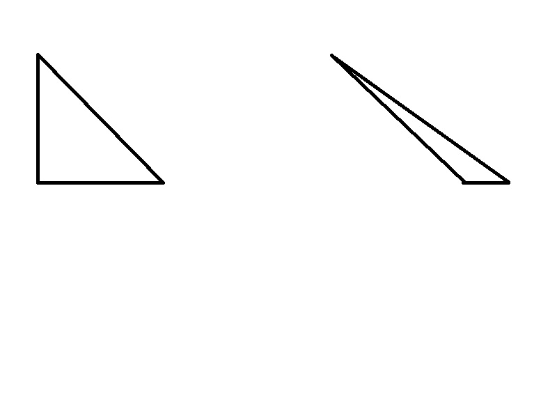

That's what I don't like about it. It's obvious that they have everything going through that rear boom purely for looks. From an engineering viewpoint it'd be much stronger to have a strut either side of the cockpit, forming a triangle (or triangular pyramid) at the rotor attachment.

Could have some x-wind directional control problems I would think. Lots of bending loads in what amounts to being a cantilever from the rotor axis, back and then forward in the fuselage structure. Form before function?. I think so. The original Cierva spanish design is purer. Maybe a tricycle U/C would aid the ground handling which I think will be interesting. Nev
Don't you think that underneath those fairings over the boom there would be some sort of boom, possibly somewhat pyrimidoidal in shape but with curved longitudinal members joined by short straight connectors.
Of course, but as per the picture below, the first structure is far stronger than the second. Or in aviation terms, the first structure can be built a lot lighter for equivalent strength than the second can.

I agree it looks gorgeous, that's not the issue. Also don't think that the side struts would reduce visibility much as they could be positioned between the cockpit openings. My point is that they've gone with the looks at the expense of either strength or weight, as Nev says, they've gone with form over function.
