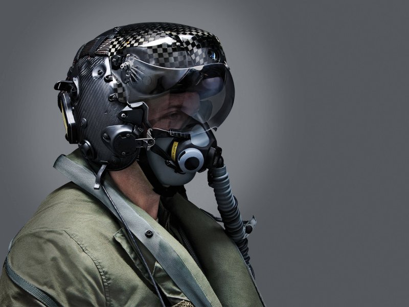

F-35 HMD helmet and mask:
One drawback to modern technology with helmet mounted display and night vision attachments is the increased neck loadings on ejection. Martin Baker has gone back to the drawing board with the MB MK.16 for the F-35, due to test dummies under 10 stone breaking necks. The lighter weight pilot is allowing the seat to rotate forward too much, causing excessive neck loads when the chute is deployed. So far, only one male pilot has had to be re-assigned; the only female pilot is over the weight limit and is not affected by the ban.
Beats me why they didn't stick with the original concept of the Russian designed K36-3.5A for the F-35 and F-22, based on the world's best state of the art seat. One reason the Russians have the edge in ALSE is that one design bureau designs seat, helmets, pressure suits, masks and anything else involved. The way we do it is to get a dog's breakfast of different contractor supplied equipment and try to cobble it together. Our left hand doesn't know what our right hand is doing, whereas a more centralized system like Zvezda's enables more focus on the main game. Corporatization is killing inovation and technology, and leading us down the path to taking twenty years to build a fighter that works.
Another ejection issue could be the mask. The main supply hose and inspiration valve hanging out the front would cause enough centre of gravity shift to add to neck loadings and flail risks. Seems to have gone backward from the older style side mounted hoses.
