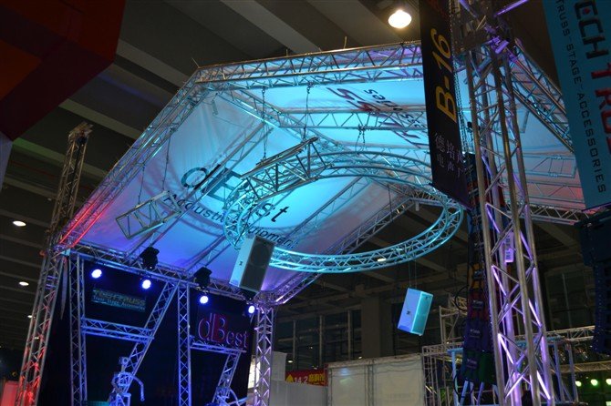

Since I have been here I have sought quality aluminium welding unsuccessfully, but recently a couple of mobs in China have gotten into stage truss supply and I went and had a look to find some pretty decent stuff including one local agent - and that ties with my "Local supply only" criteria. It's 6061 T6 or 6082 T6, all engineered and certified as it needs to be for various countries work place and safety, so I'm looking into it.
I would still rivet gussets over the welded joints for strength and redundancy, but the complete structures make assembly a much easier and accurate time saving task for homebuilders.
Just make sure that you get very good engineering advice about the fatigue of the welded aluminium connections. Stage structures are not subjected to the levels of cyclic load that an aircraft structure experiences.

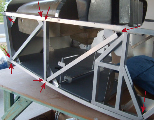

Anything welded to the primary structure reduces its fatigue life even if the varying load doesnt go through the part welded to the primary structure.
This image extract below is from AS1664.1.
This one most closely matches your detail. The variable loading is horizontal as shown by the double headed arrows. The welded attachment is not loaded but the weld will act as a defect at the edge of the member. A piece of extruded material without the weld is detail category A and this welded one D. The trouble with the curves in the design standards is that they are printed on "log-log" scales. This means that lines that don't look too far apart are very different values.
For instance, the stress that causes failure in detail A in 100,000 cycles would cause failure at about 3200 cycles if the element is welded.
Anything welded to the primary structure reduces its fatigue life even if the varying load doesnt go through the part welded to the primary structure.This image extract below is from AS1664.1.
Yes ... and the heat affected zone of the 6061 is then no longer T6, it's fully annealed to T0.
Depending on the radius of curvature and the wall thickness of the tubing, another thing you may find is that if the longerons are curved when they're welded they'll relax due to the heat from the welding, and adopt a series of facets instead of a smooth curve. It would probably be inconsistent too, some operators would weld hotter than others so the degree of relaxing of the curvature would vary.
Welding works OK for marine and transport, but welding of aluminium primary structure really isn't a very good idea for aircraft because the members are so much thinner. That's why welded aircraft structures are usually chromoly tubing. I seem to recall that Grumman tried it with aly way back, I think it might have been for a Goose or Mallard derivative, because it would have made sense to weld flying boats rather than drill and rivet them, but IIRC they had so many fatigue problems in the testing phase that they dropped the idea.

My concern isn't the weld failing but that the weld causes a crack to start in the primary member that then propagates. I have tried to show the situation in the sketch below.
It might be that it is all fine. I don't know the loads and the member sizes. Just get someone who has an engineering background in fatigue assessment to have a proper look at it.

I'm not sure you're right about that. Previously you (like Morgan and others) had your longerons attached to verticals and diagonals with riveted gussets. In terms of the truss your longerons are your top and bottom chords, and your verticals and diagonals are your web members. By necessity your web members are individual but your chords MUST be continuous, or spliced with a moment connection, or else it isn't a truss. When they were riveted your chords were continuous but by adding welds every so often along your longerons/chords, you've effectively broken them up into pieces - or will have once the fatigue sets in - and the additional riveted gusset does not constitute much of a splice. Once the chords start to crack up you won't have a truss, or, effectively, any longerons. So if you're building something where your load paths are as distributed as you claim, why bother to have longerons and/or a truss in the first place? If widely distributed load paths are your design intent why not build a proper monocoque like the RVs? Cheaper, lighter ... and compared to this case, far less prone to fatigue failure.
