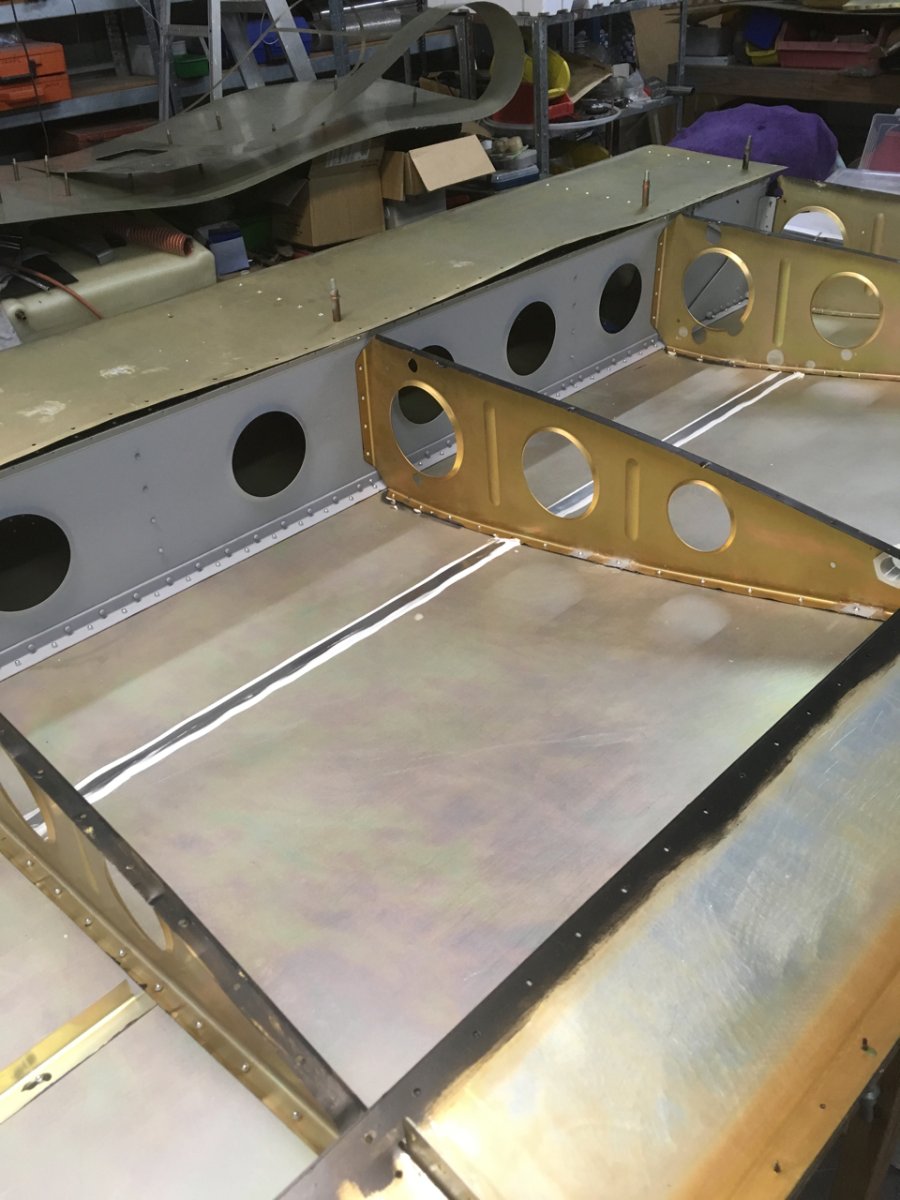

Alodine is the rolls royce of protection but it is a lot of work. The Savannah rebuild is all alodined but I wont do that on the RANS S-21. I am actually going to do the ICP thing. I havea full tin of the black goop and will get another and I will use the back stuff on all the mating surfaces.
I am not going to worry about priming the insides of the sheets. My experience now of several systems and also pulling 10year old aircraft apart if you do the black stuff correctly its works a treat. If you are a bit light on with the black stuff then I have seen corrosion between stringer and sheets. Done properly it works well and that black stuff even though it is water based is bloody tough .
So I am pretty sure my RANS will be the only one done like this. Its about 50/50 in the USA for either chromating everything inside or not doing anything with the S-21's that are being built there.
I use a roller about 25mm wide and roll it onto the sheet and stringer then you let it dry then assemble...its a Italain product and have never been able to buy it here but we did find a product that maybe similar. I will have to find the details again
You can see the black stuff here on stringers and ribs and spars etc where aluminium mates to another piece
IMG_7683.thumb.jpg.fd97492fb0c381ae98fcb614002f317e.jpgIMG_6956.thumb.jpg.bed4495b4dc1d0426cf9d930556620ef.jpg
