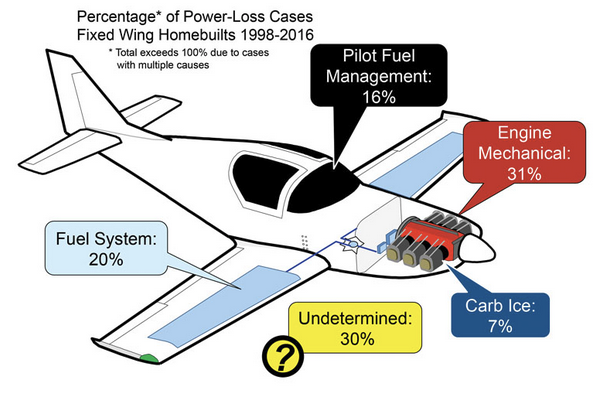

skippydiesel Posted October 8, 2021 Share Posted October 8, 2021 9 hours ago, Ian said: Hi Skip, We weren't talking about sales were were talking about design. You sited Kitplanes - a promotional publication closely allied to sales as is journalistic commentary on most products. You were of the opinion that paper filters were no good - My comments centered on what I see as garden engine fuel filtration product's (the small el cheapo paper types ). Never said they are no good, strongly suggested they are not appropriate for aviation use. and ventured the opinion that mesh filters were the "aviation grade" ones which could be seen as a sales gimic. - Who said anything about aviation grade? True I see a fine mech filter, encased in a light weight, transparent, almost indestructible casing, pretty much guaranteed not to leak, as a preferable product to the aforementioned garden variety Nev mentioned that he wouldn't use a filter without barbs as the filter you displayed didn't have barbs. So? You then stated that barbs were just for a warm fuzzy feeling. Yep! The good old barb, very much superseded by the better designs I (& you) referred to. Thruster88 showed a hefty turbine with an paper filter I acknowledged the Aviation Certified pleated "paper" media filter, fully tested, quality controlled throughout manufacture and suggested it bore little resemblance to the garden variety that this post centered on - your point? I stated that barbs and raised collar provided a mechanical advantage especially when used with a clamp. I have always supported the raised collar/single smooth barb design of fitting (along with the plain pipe/tube) and the use of appropriate clamping system. I am implacably apposed to the old style multi barb (beloved by so many) but agreed it gives a "mechanical" security , completely negated by its poor sealing performance and potential to damage the inner lining of the hose - what is your point? The rest is just going around in circles. Like so many oft repeated discussions on this Forum - still little gems arise from time to time to keep one interested 1 Link to comment Share on other sites More sharing options...
