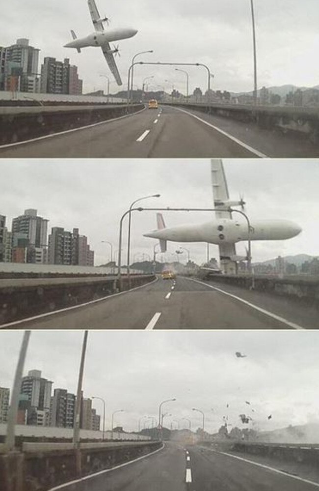

red750 Posted February 7, 2023 Author Share Posted February 7, 2023 Very reminiscent of this crash immediately after takeoff of TransAsia 235. Just watched the Air Crash Investigation report. In that accident, a faulty torque sensor caused automatic feathering of the starboard propeller and the pilot shut down the wrong engine. 1 Link to comment Share on other sites More sharing options...

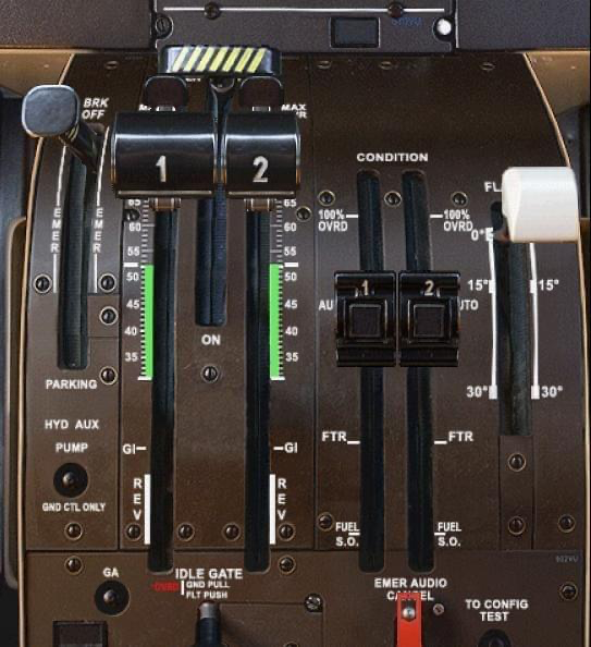

kgwilson Posted February 17, 2023 Share Posted February 17, 2023 Flap was lowered to 30 deg, 23 seconds after both props were feathered and both pilots noticed there was no power coming from the engines (presumably from the CVR data) but it seems neither realised the props had been feathered which seems from the photo of the controls, blindingly obvious. 20,000 and 16,000 hours of experience and it is human factors that raises its head. Everyone makes mistakes and this was the one that created this tragedy. 1 Link to comment Share on other sites More sharing options...

facthunter Posted February 18, 2023 Share Posted February 18, 2023 Murphy's Law. It's a lever lock I would say but needs some other precaution so you can't actuate when it will kill you. (Like on approach). Is that the method of shutting down the engines at the end of the day? The props are in the feather position then and until restart. It's a "free spool" engine. Nev 1 Link to comment Share on other sites More sharing options...

Carbon Canary Posted February 20, 2023 Share Posted February 20, 2023 ATR prop condition and flaps levers side by side. Full feather and flaps 30 lever movement would be very similar. If you were distracted by new airfield approach, tired, etc, may be easy enough to swing the wrong lever by memory feel rather than positively identifying what you had your hand on. 1 Link to comment Share on other sites More sharing options...
