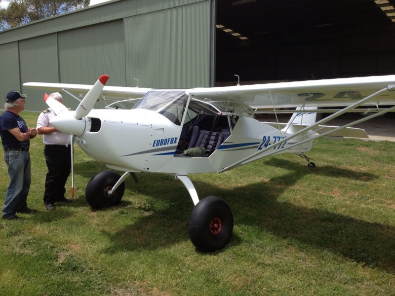

The eurofox at Lilydale is 580 mtow, might be an option, and it's squirrelly enough to teach you well, the citabrias are a great plane but not many other taildraggers are as nicely mannered.[ATTACH=full]23852[/ATTACH]
Nice picture too, MM!
