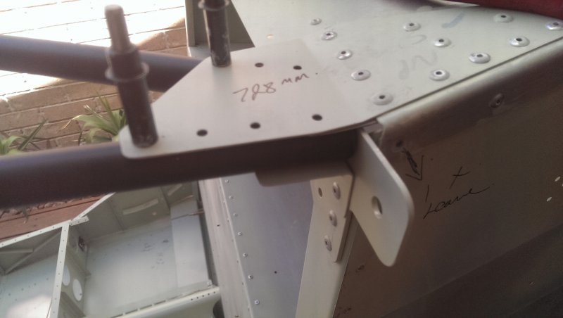

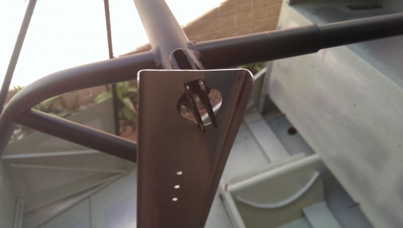

Lyndon Posted December 5, 2015 Author Posted December 5, 2015 Wing distance ????. 728 plus or minus 1mm. Measure from where. The front mount has two lugs and guessing the wing locates in the center. Distance between the front and rear lug. Or center of both. I only want to drill these once. Yep I want the wing to fit first time. Advice ???? Thanks Lyndon
facthunter Posted December 5, 2015 Posted December 5, 2015 There are innumerable ways to be wrong and only one way is right. Do you guys use templates? Let me know if it's a silly question. Nev

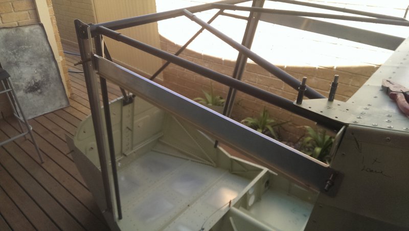

Lyndon Posted December 5, 2015 Author Posted December 5, 2015 I'm using the factory template. Happy with the diagonal on top. But the legs look to long and are not parallel with the row of rivets. By the manual at this stage it looks only the top is riveted.
rick morawski Posted December 5, 2015 Posted December 5, 2015 Quote Wing distance ????. 728 plus or minus 1mm. Measure from where. The front mount has two lugs and guessing the wing locates in the center. Distance between the front and rear lug. Or center of both. I only want to drill these once. Yep I want the wing to fit first time. Advice ????Thanks Lyndon Nobody knows where that distance is measured. Dont worry, if you mounted the frame up with the jig in the correct holes then it will fit. The important bit is the diagonals on top must be equal before drilling. If the vertical legs are long and foul with the extrusion from the cabin side its ok to trim enough to fit and no more. Its harder to get the first hole in the vertical leg because you have the jig clecoed on but you will get it.

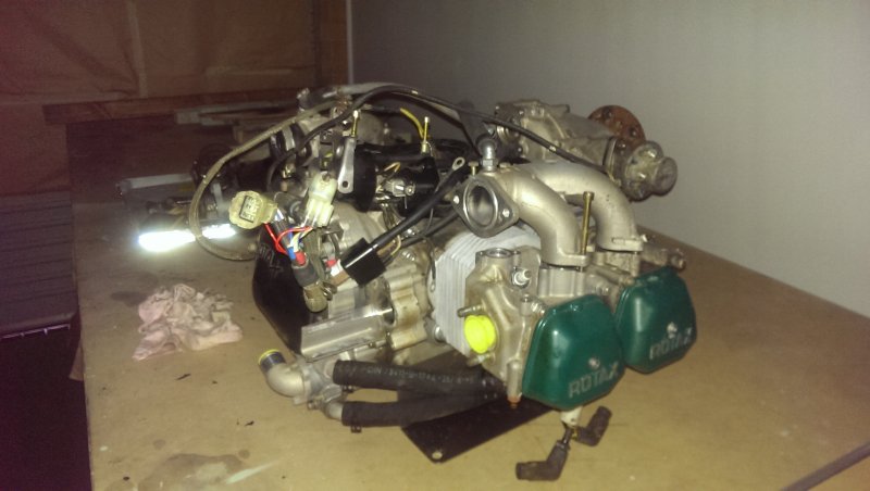

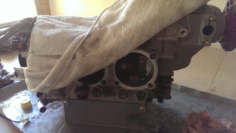

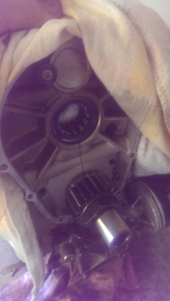

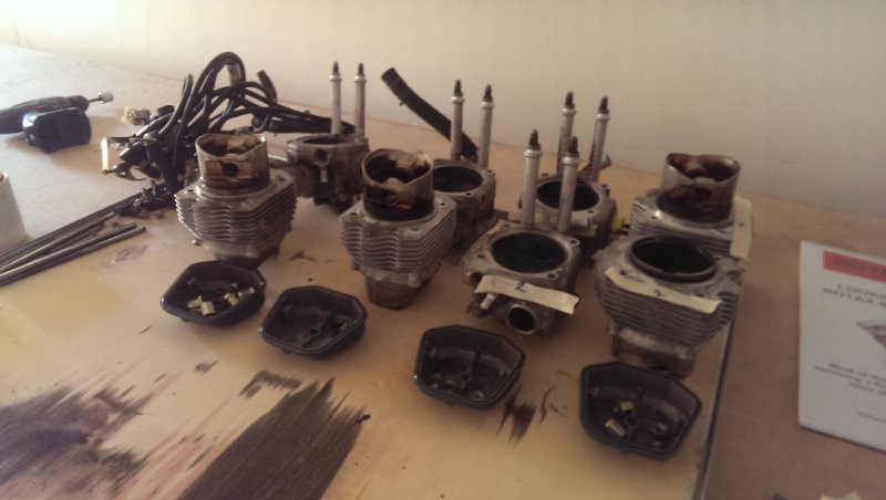

Lyndon Posted December 13, 2015 Author Posted December 13, 2015 Taking a break from construction and doing what I really like. My thoughts on the Rotax 912 . First I wish the Japanese built one but anyway we will have to put up with Austrian engines for now. 2010 or 2011 not quite sure. 1740 hrs and it's mine. Pulled it apart and first impressions are it's made so simple and easy to work on. Not all orings seal perfectly which is normal for a European engine thus it's not as oil tight as is should be. Cooling system has quite a few leaks. Yep it's not Japanese. Inside the cooling system is perfect. Nil corrosion. Inside the engine is also very good. No sludge but at oil change intervals and how it's used I would expect better. The lifters are worn. I blame the oil for this. The oil rings are badly carboned up as is the heads and piston crowns. Bore pistons rockers valve seats guides etc show virtually no wear at all. The cam is fine upon initial inspection and will go around again. The front reduction unit is also perfect. Inlet valves are perfect and the exhaust have some marking but are now fine after a very light lap. Overall if this engine had better oil it would be only just run in at these hrs. The carbs also look perfect albeit very dirty etc. The oil pump is also like new. So lifters. Valve stem seals. Maybe a light home. Valves lapped. Some oil control rings new gaskets and seals and would be very disappointed if it didn't do those hrs again. Lyndon
eightyknots Posted December 14, 2015 Posted December 14, 2015 Lyndon, is that the 80 hp or the 100 hp 912?
Kyle Communications Posted December 14, 2015 Posted December 14, 2015 They are nikasil bores so be careful honing them
Kyle Communications Posted December 14, 2015 Posted December 14, 2015 I see you are doing the cabin frame. Be very careful with that you can really stuff it up if you do not measure diagonally across it and get it within 1 mm or less otherwise you will be putting addon trim tabs on a aileron to stop the roll. Lots of guys have stuffed this part up.
