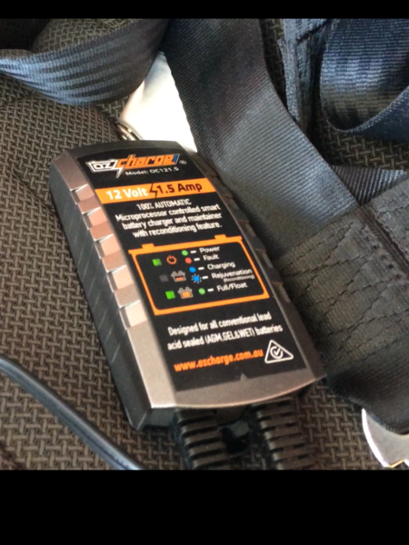

Bennyboy320 Posted May 3, 2018 Share Posted May 3, 2018 Whats with all this battery charging, if battery wont hold charge between flights, replace it. Because if you don’t use the a/c on a regular basis your battery will slowly loose its charge, hence my example, only using the a/c a few times a year the trickle charger means I won’t be faced with a flat battery when I want to go flying. Link to comment Share on other sites More sharing options...

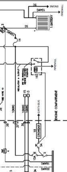

jetboy Posted May 3, 2018 Share Posted May 3, 2018 Jabiru draws around 15mA with the master off, thats .36 Amp/hour per day or around 1 A/hr every 3 days. With the standard 18 A/hr battery it will need either a trickle charge or a boost charge after a couple of weeks. Because I have no mains power at the hangar I use a small solar panel across the battery. The small ones are not capable of overcharging my 24 A/hr battery and are safe to clip on to the terminals and leave day & night. - sold at Jaycar for camping boating etc. they are 6 Watt. Larger panels will require a regulator. If I had mains power I'd be using a plug pack type trickle charger. The least trustworthy chargers are ones with fans for cooling, not only can they put out serious power they also heat up and if the fan gets blocked they will burn up themselves. AGM SLA really work best with a regulated supply, around 13.6 float, so the old chargers with the moving iron Ammeter and 6V / 12V switch are also a bit risky for overcharging. Link to comment Share on other sites More sharing options...
