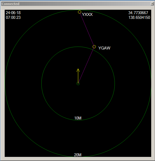

Jabiru7252 Posted July 8, 2018 Share Posted July 8, 2018 To keep my brain working, I'm currently developing a simple navigation application that will run on Android phones and tablets with GPS capabilities. The display is similar to what you might find in commercial aircraft. Your current location is in the centre and the pre-loaded waypoints and track are displayed. In the example image, you would turn right to take up the track to YGAW. I'm curious as to what sort of interest there is in such an application considering there is Oz-Runways and cheap car GPS units that provide good navigation data. My app would be free! The current development is on my Windows 10 computer using Visual Studio for those that care... 9 Link to comment Share on other sites More sharing options...

Jabiru7252 Posted July 10, 2018 Author Share Posted July 10, 2018 My app will not use a map. Doesn't need one. The user just loads in the way-points and follows the track. Ken, I applied for a 'key' that allows me to use Google maps on Android. The key unlocks the API (code) that programmers access to use the maps. Downunder, this app has a black display as does mine. Looking carefully you can see 'something' other than a black screen. As I said, it's just something to keep the grey cells alive and improve my programming skill. 4 Link to comment Share on other sites More sharing options...

Jabiru7252 Posted July 11, 2018 Author Share Posted July 11, 2018 This app will only work if the phone or tablet has a GPS chip installed. It won't be using the phone network or WI-FI for location services so it could be used anywhere. 1 Link to comment Share on other sites More sharing options...
