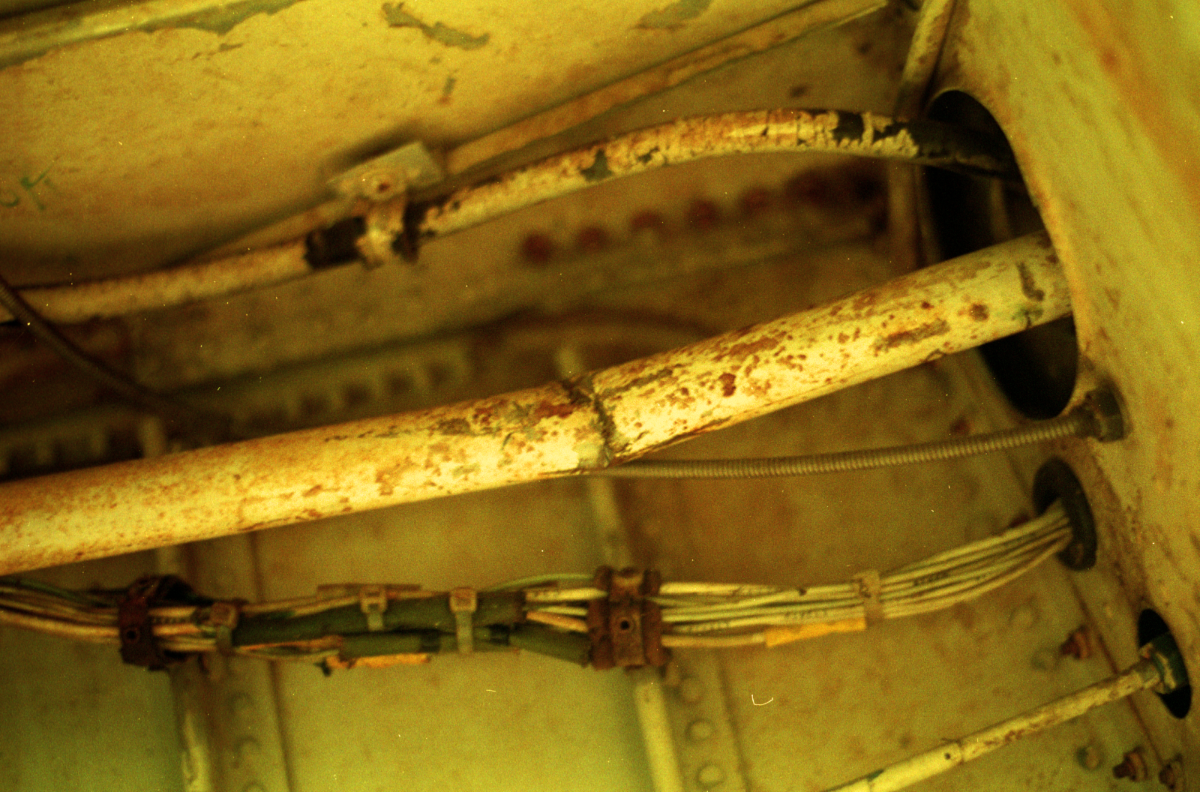

marshallarts Posted October 11, 2022 Share Posted October 11, 2022 7 hours ago, kgwilson said: Which means the gear mechanism or some other component must have jammed/broken Yes, in my dear old Debonair in a past life, the pushrod/tube cracked and bent in the tunnel leading out the wing. I had wondered why I'd been hearing a "clunk" when I lowered the gear - it was the pushrod near the kink point, banging into the wing structure. See pic below. Fortunately it never led to a failure to be able to lower the gear - it was found at the next 100-hourly. And fortunately the hole in the rib it passed through was small enough that the bend in the pushrod didn't shorten it enough to prevent full gear extension. Very lucky there, it certainly would have failed completely, in the not too distant. I was always very impressed with the design of the gear mechanism on the Deb (same as Bonanza and Baron too I believe) - just one motor, with several gears/arms etc and the pushrods, which opened the gear doors and extended the gear, and then closed the small inner doors as well (I think), with just one spin of the motor shaft. Then the reverse to retract. A very clever piece of engineering. But everything with moving parts can/will fail eventually! 1 1 Link to comment Share on other sites More sharing options...
