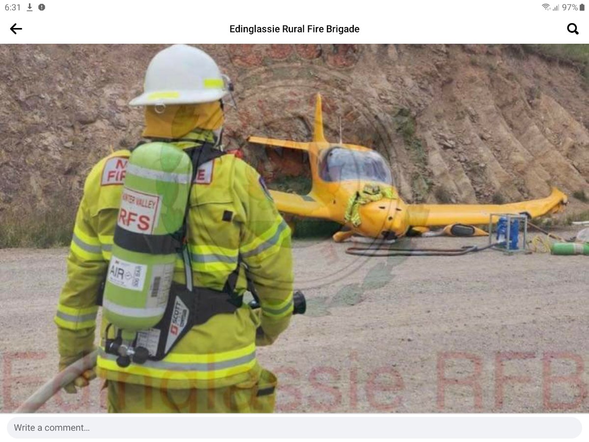

BrendAn Posted December 3, 2022 Share Posted December 3, 2022 https://m.facebook.com/story.php?story_fbid=pfbid0B2VcDQrefiFqEyg38Xk1nYt15VMSbC9PNryrKHDoMEy25vmH3nFQzcV9SWYfDox5l&id=100064429850081&mibextid=Nif5oz Link to comment Share on other sites More sharing options...

Thruster88 Posted December 3, 2022 Share Posted December 3, 2022 Ex soar bristell? Propeller appears to have been turning at impact. 1 Link to comment Share on other sites More sharing options...

RossK Posted December 7, 2022 Share Posted December 7, 2022 Kangaroos doing what they do best. STATUS: Under review OCCURRENCE DETAILS SUBMITTED TO RAAUS: The aircraft was tracking BAXT to YSCO at 2500 feet. Approx. 25nm south of Scone, an unusual noise developed in the aircraft and got progressively worse over a period of approx. three minutes. Power was reduced and a severe vibration commenced. A call was placed to Brisbane Centre that the aircraft was experiencing difficulties and would be immediately commencing a precautionary search and landing and an approx. position given. A quarry haul road was selected as the best option due to the terrain and proximity of a farm residence. A decent was immediately commenced with a track over the farmhouse at low level. A landing was commenced on the haul road. Once established on the ground and about 80 metres into the roll-out, several kangaroos came across the road and one or maybe two were struck by the left wing of the aircraft. This placed the aircraft into a sliding rotation and the right wing struck the embankment which resulted in the aircraft rotating further and coming to rest against the embankment at 90 degrees. This had caused the nose-wheel to collapse and the left main damaged in the table-drain. The pilot shut down all systems and exited the aircraft uninjured. 1 4 Link to comment Share on other sites More sharing options...

Thruster88 Posted December 7, 2022 Share Posted December 7, 2022 I was thinking the propeller blades sheared of in the landing. Reading the report about increasing vibration perhaps they went fa coffee. Link to comment Share on other sites More sharing options...
