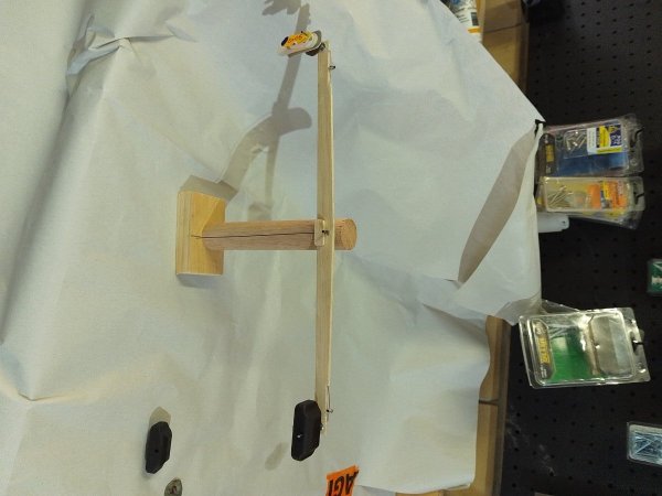

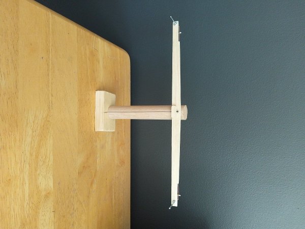

skippydiesel Posted September 28, 2023 Share Posted September 28, 2023 Rotax recommend a "rubber" replacement every 5 years - little to be gained by doing this at 2-3 years, other than a lighter wallet. Be careful of "kits" that supply parts that you don't need - weigh your floats (the expensive bit) befog commiting to new ones. Rotax have the weighing procedure & max weight, in their maintenance manual. Jewellers scales (for weighing floats) are not very expensive. Link to comment Share on other sites More sharing options...
