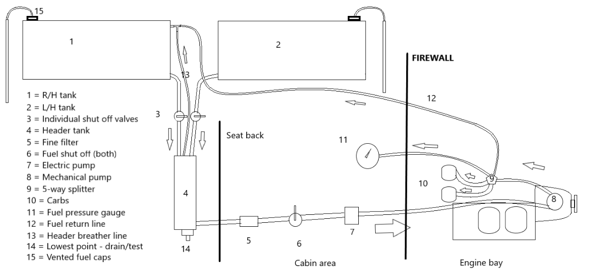

  19. New diagram:

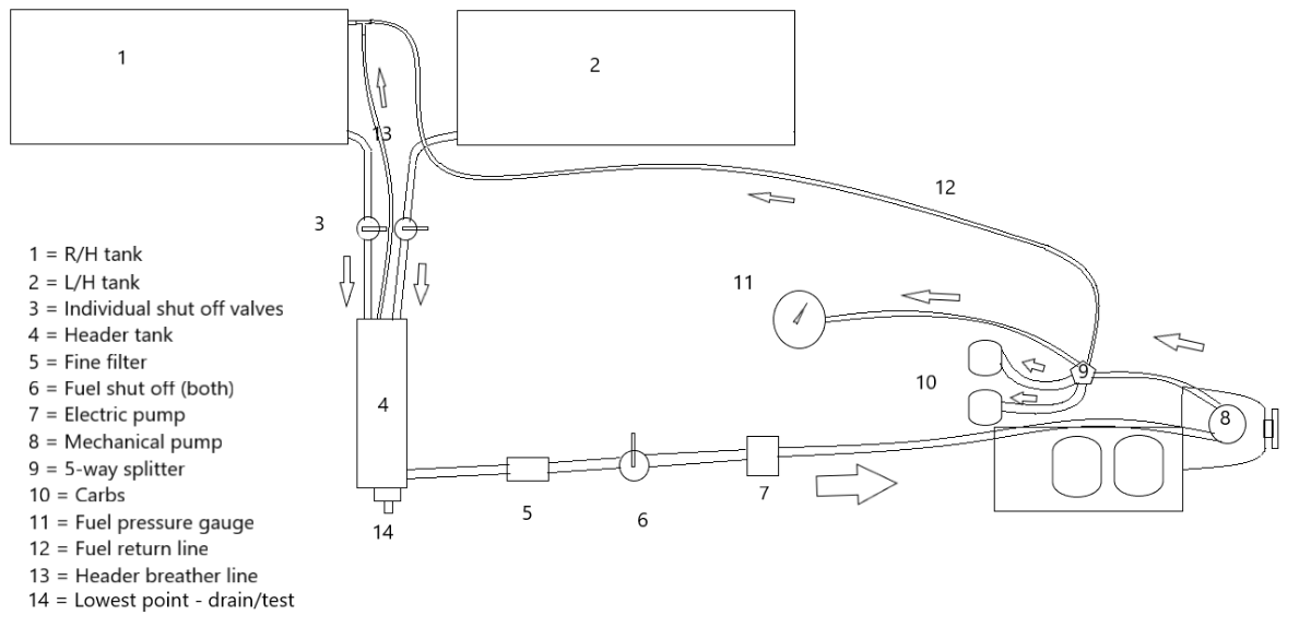

  21. Hi Nev, As Bob says the T would be on the fuel return line. Theoretically if the fuel return line were full of fuel (not sure how likely that is with 1/4" line) then it could spill down the T'd line into the header tank - so that doesn't matter either. I guess the main thing is that if any air does get into the header tank, it finds the highest point and goes back into the top of the tank. This is just to keep the low fuel sensor off so I don't have unnecessary involuntary clenching. A diagram of what I'm thinking is:

  23. So it seems like I should stick with 3/8" from the tanks onward. On the R/H tank I have a 1/4" fitting at the top for fuel return. According to the Rotax Heavy Maintenance manual, this comes from a 5-way fitting bolted to the compensation tube running between the carbs. 1) Fuel in from the mechanical fuel pump 2) and 3) Fuel out to the carbs 4) smaller fuel out to the fuel pressure gauge 5) smaller fuel out (return) to the R/H tank. That's fine. But the other thing I have on the Savannah header tank is a breather tube that's meant to go to the top of a tank (usually the L/H one I believe). My tanks are hard to get to - unlike the Savannah, the 701 doesn't have an access panel below the tanks. So if I want to get a tank out to modify it, I either have to drill out a fairly large area of wing skin rivets or cut the aluminium away under the tank and replace with a panel (either riveted or screwed) like the Savannah. So I'm trying hard NOT to modify my tanks in any way! Question 1: Could I put a T fitting on the 1/4" hose that comes from the TOP of the R/H tank (this is the fuel return) and run the header tank breather to that? If the T was very close to the tank would that work? Question 2: What diameter hose/pipe do people use for the line to the fuel pressure gauge, and also the fuel return? I'm thinking 1/4" for the return because that's what I have at the tank end - is that standard? Below is a photo of the R/H wing root with top root skin removed, showing the return line at the top left side and the fuel main line at the bottom right side. So question 1 refers to plumbing a T into that top left return line, right before that rib beside the tank, then running that down to the header tank as a breather line. Thanks! Cheers, Marty
  24. Hi all, Trying to work out whether I can get away with 1/4" ID aluminium tube from the wing tanks down to a Y or T junction before the Savannah header tank. From there the single hose can be 3/8" which I think is the barb size at the top of the header. (I can also use 3/8" from the header to the engine). Reason being, I have 4 panel-mount quick release fittings from Aircraft Spruce which I want to use in the wing roots, in case this becomes a trailerable aircraft. These are 1/4". Back of the envelope tells me the area of a 1/4" cross section would be 31.66 sq.mm, so 2 tanks = 63.33 sq.mm. Compared to this a single 3/8" area would be 71.2 sq.mm However I have had advice that it's all about ensuring sufficient fuel flow, based on a maximum of 27LPH for the 912ULS. How do you calculate this? There are online flow calculators but one of the variables is pressure (bar). Is there a set variable for this based on the mechanical fuel pump at the front of the engine? Thanks, Marty
