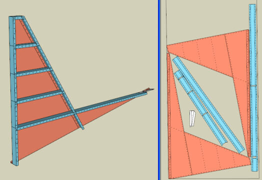

And we'll need a HS and spars too .. I won't draw the skins up until I laser and fold the spars, and assemble with the ribs to get accurate measurements. -

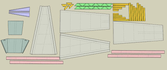

The complete rear fuse, now a few days more to translate it all into 2D CNC files (.dwg or .dfx doesn't matter) and start cutting some sheets later in the week ... -

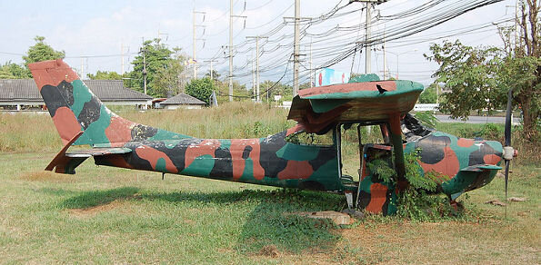

Did you know there's one rotting in a public park in Thailand? In fact isn't it in your city of Chiang Mai? Here it is, you're welcome... https://en.wikipedia.org/wiki/Peterson_260SE

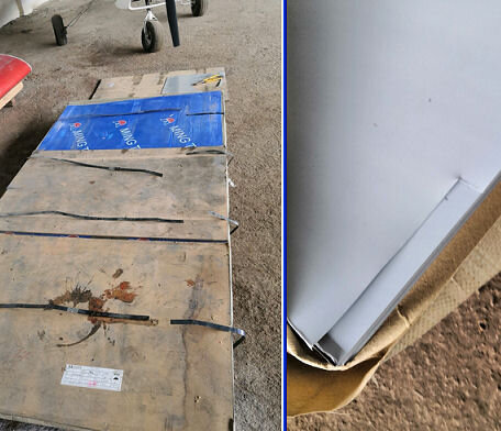

Yay, sheets just arrived. ..and of course first thing is to cut a strip and send it of for testing to confirm what it really is. I did some very simple tests though, yeild, curvature and spring back against previously tested and confirmed 6061T6, and good news that those were identical, but I'll let the Lab decide that. -

Yes, should be back to standard size sheets later, that's why I'm not renesting just for this batch. Transport company didn't ring me today, hope tomorrow now. -

As Big Kev says "I'm Excited!" .. Aluminium arrives tomorrow, like a Kid at Xmas, Yay! Sadly they only had 1250 x 2500 sheets, I usually lay everything out on standard 1220 x 2440 sheets, so I will have to suffer a little waste as I'm not going to renest everything again. You would be surprised what a difference 60mm longer and 30mm wider makes to nesting, spreading parts over 30 or so sheets. That also goes for the actual design, you can't make a part that won't fit onto a sheet, or cut up into at least the minimal part sub lots. But Sketchup will save me, Long Live Sketchy, Sketchy for King!! -
