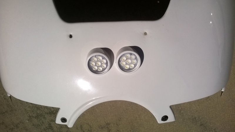

  6. As far as my aircraft is concerned I have already done that and the manufacturer has given me the ok provided I don't change the wiring and fit a 50w LED replacement bulb in place of the halogen that was in there originally...it was a very simple change over until I turned on the radio and got all this interference... I need to fit a EM compliant LED...simple I thought....mmmm maybe not so.. David
  7. jetjr, I don't think ferrites will stop the interference as it is coming from the LED bulb itself, not the wires...you can try I guess.. David

  11. jetjr, From what I have found out it is the wiring/board inside the LED that creates the EM interference, not the wires or power supply, we need to find true clean LED's but that is the problem as they all say that theirs are compliant...as far as my LED's are concerned they are not...I hope to go and talk to another supplier tomorrow that seems switched on to the problem, I will keep you updated on what I find out... David
  12. Yes I will chase up the correct LED's today through the supplier that supplied me the one's I fitted, I will also ask him why he didn't give me the correct ones in the first place as I did explain to him it was going into an aircraft...they needed to be EMC compliant as per the info that Mike sent me, thanks again Mike. David

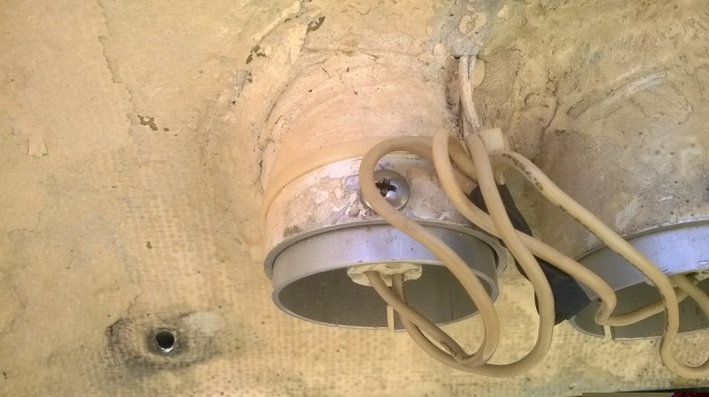

  14. We have twin 50 watt landing lights in our Sportstar which were your normal bulbed type lights, we decided to change them to LED's, very simple change, we did not have to change any wiring just take the old units out and fit the LED's in. We went a fly today and there is some sort of interference that affecting the radio, we couldn't work out where the noise was coming from until we turned the lights off once we did that the noise through our headsets was gone, never had this noise when I had the old bulbed lights in the plane. Does anyone have any idea on why we would be getting such a noise and how we can suppress it, any help would be appreciated, thanks. David
