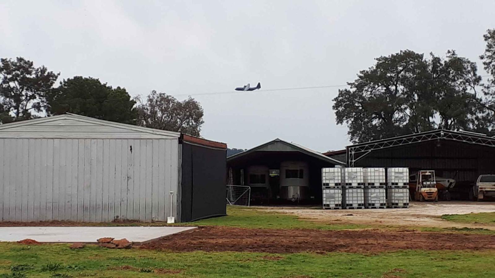

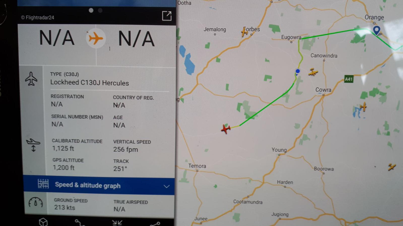

Thruster88 Posted August 14, 2020 Share Posted August 14, 2020 Had another visit this morning. I like seeing big, fast aircraft up close when on the ground. EC devices are good for everyone. Link to comment Share on other sites More sharing options...

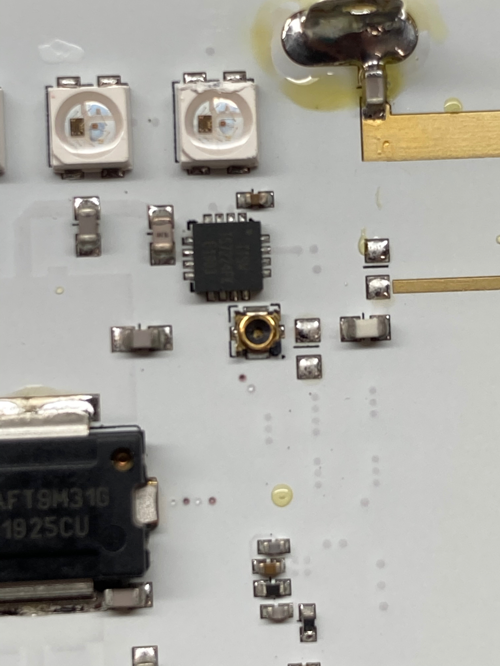

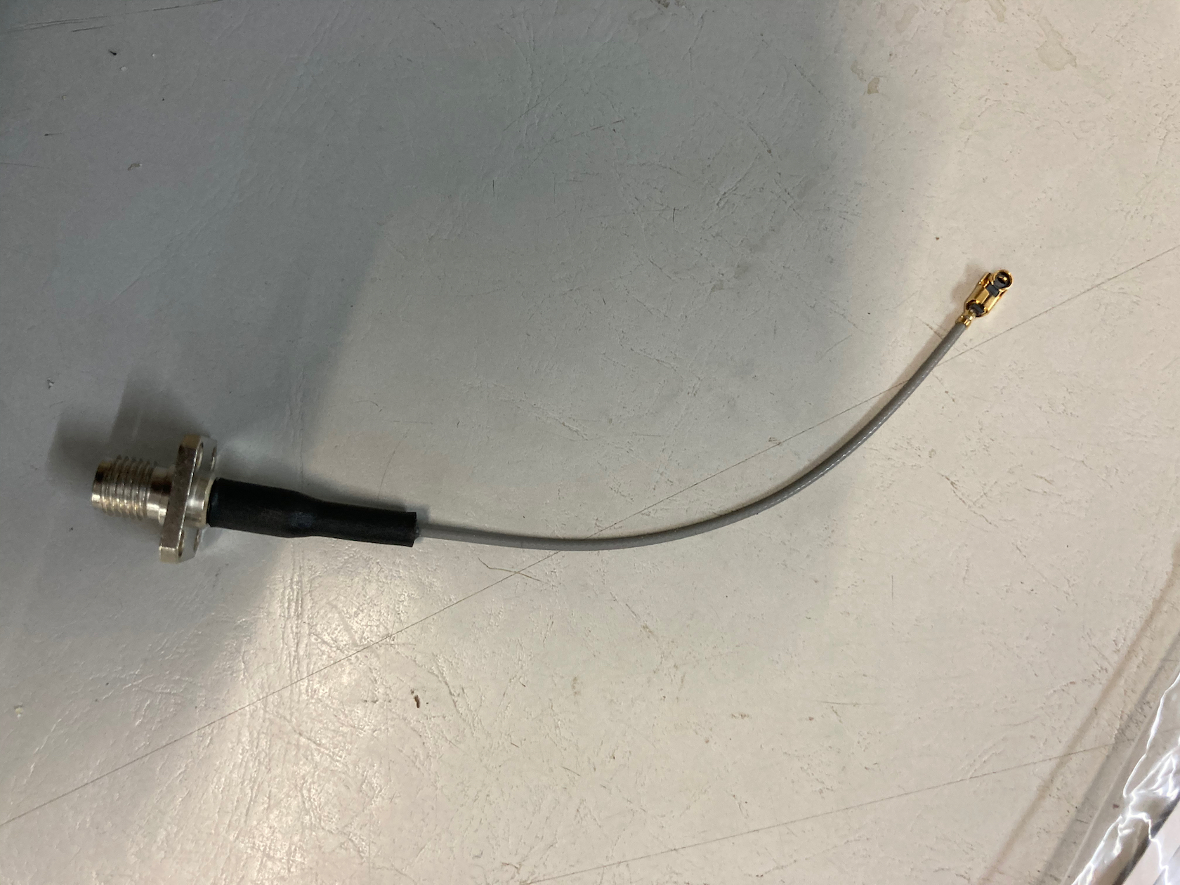

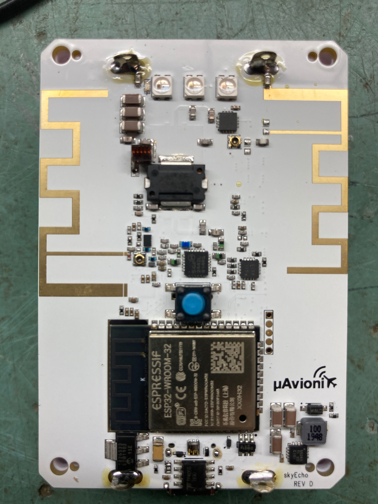

Kyle Communications Posted August 20, 2020 Author Share Posted August 20, 2020 Maybe some sort of capacitve radiation into the lead but at 1090 mhz the antenna is very short and the USB cable is long...I dont know why..maybe more power to the transmitter when attached to the USB Picture attached of the inside of the SkyEcho...its super easy to connect a external antenna. The antenna on the left is the Flarm/UAT antenna on the pcb and the one on the right is the ADS-B 1090 mhz antenna. You can see 2 small connectors near each antenna. These have a switch inside them for when they are tested. If you clip on the antenna coax tail it cuts out the onboard pcb antenna and then your signal can go out to a proper Transponder antenna 1 Link to comment Share on other sites More sharing options...

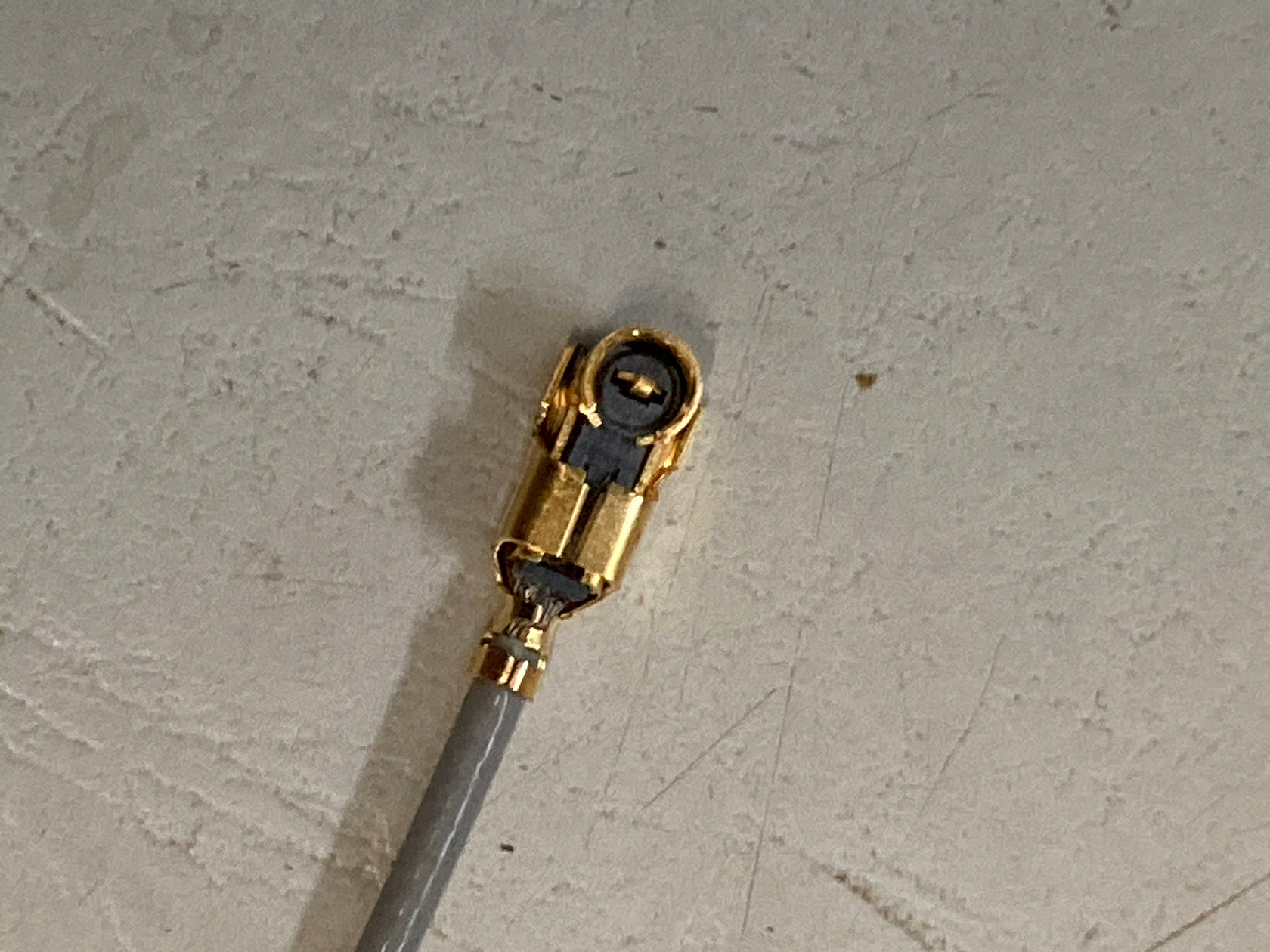

Kyle Communications Posted August 20, 2020 Author Share Posted August 20, 2020 Close up of the antenna connector..it is 1.3mm in diameter Link to comment Share on other sites More sharing options...

Kyle Communications Posted August 20, 2020 Author Share Posted August 20, 2020 Glen I am not sure if you know what the SkyEcho 2 does but its a neat relatively cheap device for being really only for local aircraft to aircraft ops. So it is a short range device somewhere between 10 and 40 nm. It would be far better as you know not to have the onboard microstrip antenna to get increased range as this may be better for the ground station visibility. When I got mine I had a look at it to see how easy it would be to fit a proper external transponder antenna to it...which by the way in the paperwork says you are not to modify it in any way..but we all know what that means :) These micro style connectors are pretty sweet for this purpose they are designed so of course to tune and check parameters directly there are special push and hold in coax connectors into the females you see on the pcb that of course just go to the test gear for setup and alignment. That connector has a small wafer inside so it totally disconnects the pcb antenna. After much searching I found the company who makes the connector..never heard of them before but they are quite large apparently. I got a couple of samples but they were the wrong size too big :(... so between myself and the rep from the company we found the right one but the bummer is they do not make the small attachment connector for that size that we can use a tail for. They only make the push on test connector. So still easy enough to add a external antenna just not as simple as plugging a tail into it its a soldering job Link to comment Share on other sites More sharing options...
RFguy Posted August 20, 2020 Share Posted August 20, 2020 Hi Mark Looks like an MHF4 connector (1.3mm across the receptacle cylinder..). Ipex originally. but some variation. Is similar to a U.FL connector (1.8mm width receptacle cylinder) I use alot of U.FL . MHF4 are a bit of a pain. too small. good for like 5 cycles. I have various cables like this if you need something . be sure to lever up from behind- under the crimp and tilt forwards Link to comment Share on other sites More sharing options...
Kyle Communications Posted August 20, 2020 Author Share Posted August 20, 2020 MHF SW-20 is the connector Link to comment Share on other sites More sharing options...
RFguy Posted August 20, 2020 Share Posted August 20, 2020 Thanks for the info - I didn't know the SW20 existed ! Have used SW23 (about 50% larger) . Link to comment Share on other sites More sharing options...
Kyle Communications Posted August 20, 2020 Author Share Posted August 20, 2020 The picture you see there is the SW23 Link to comment Share on other sites More sharing options...
