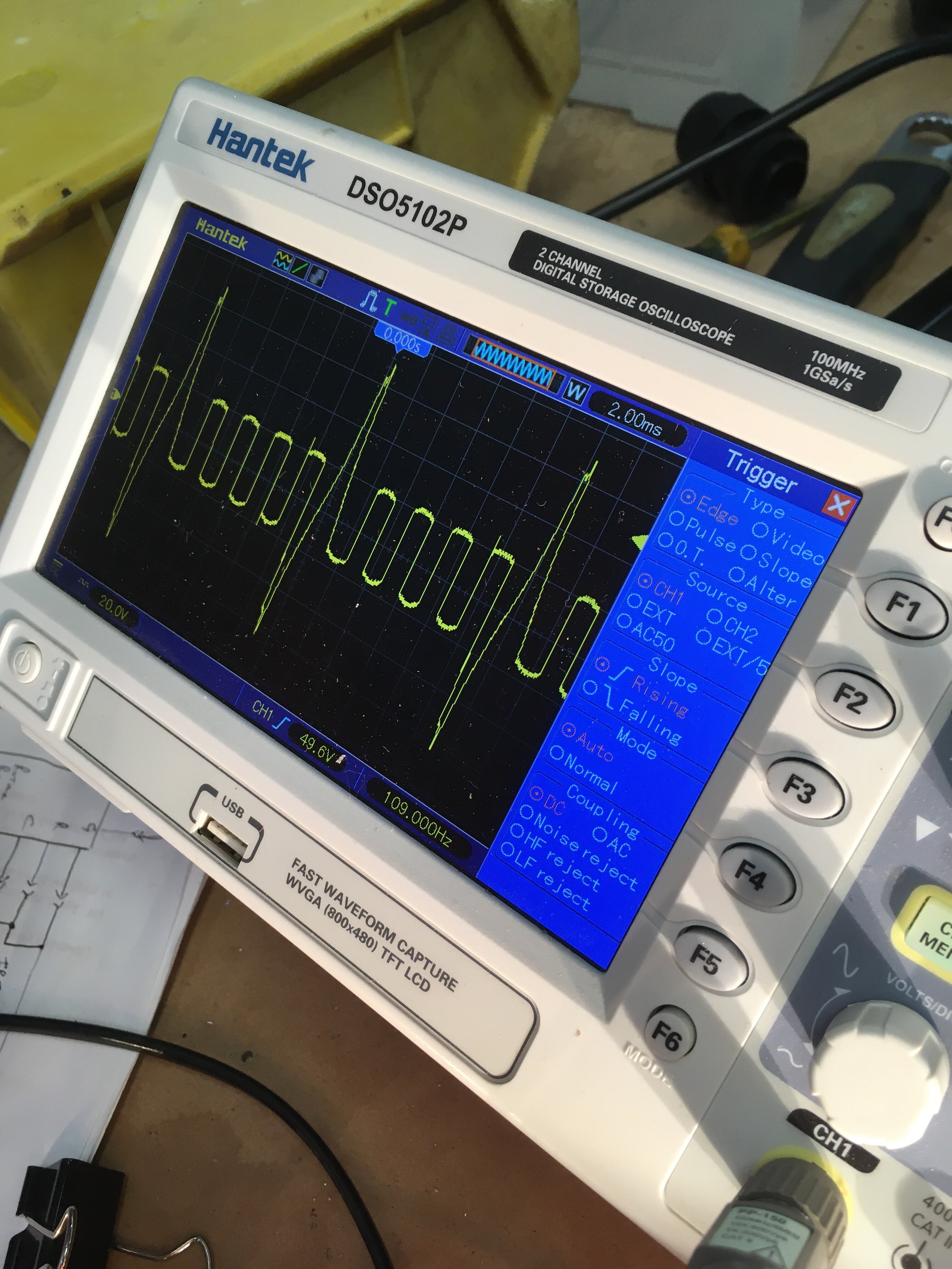

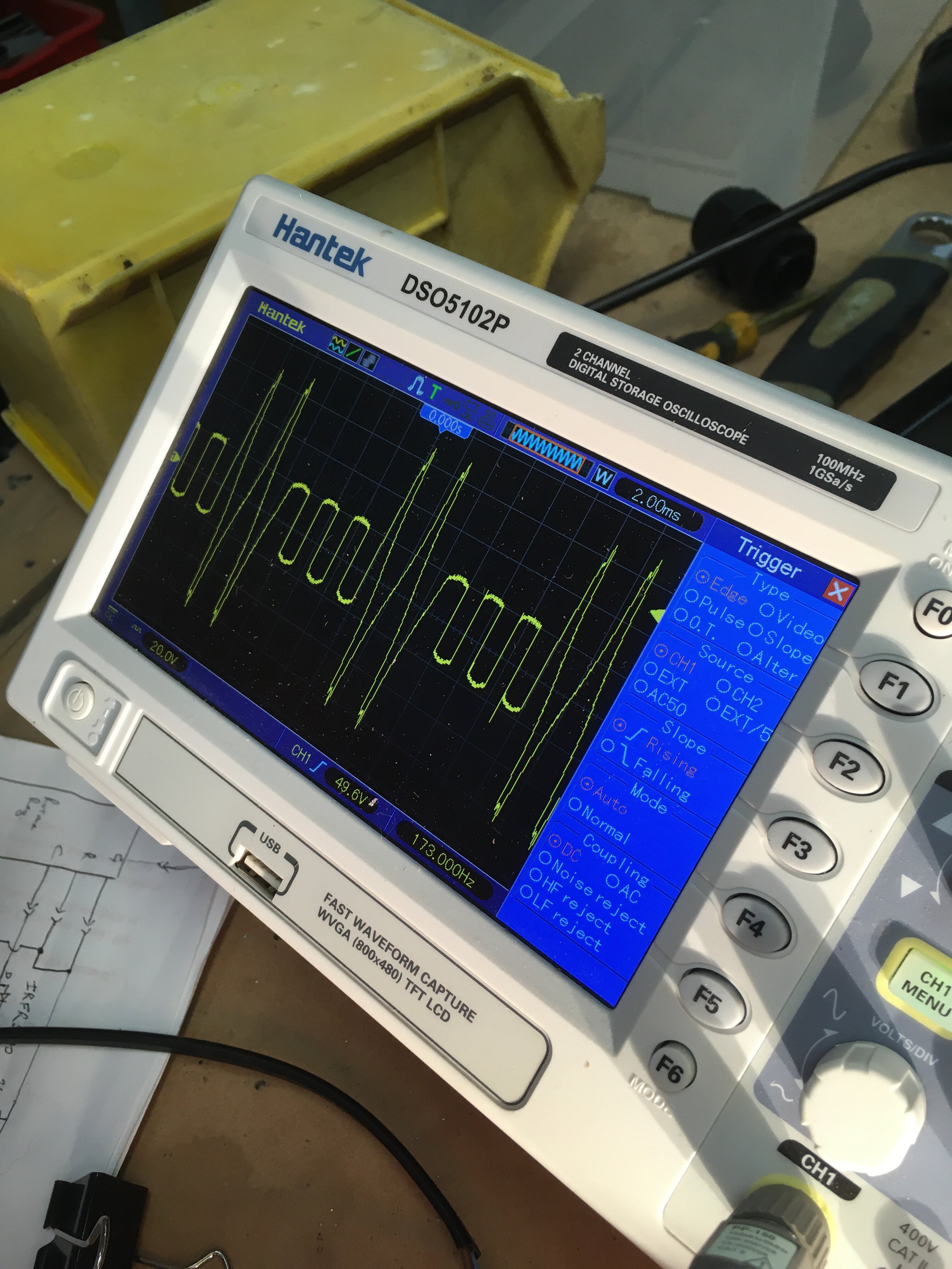

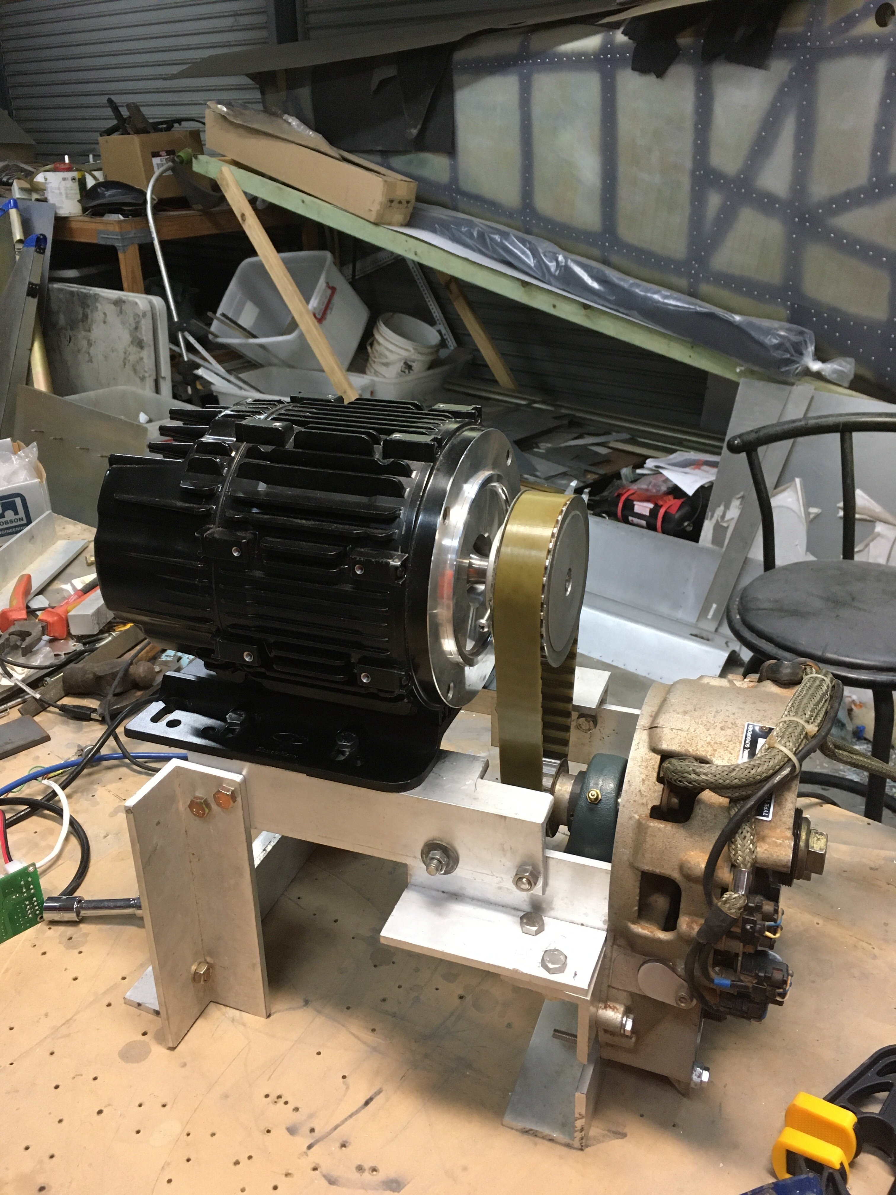

If you havent seen the output of a Rotax generator this is what it looks like
I can drive my test rig from 0 to 5000 rpm

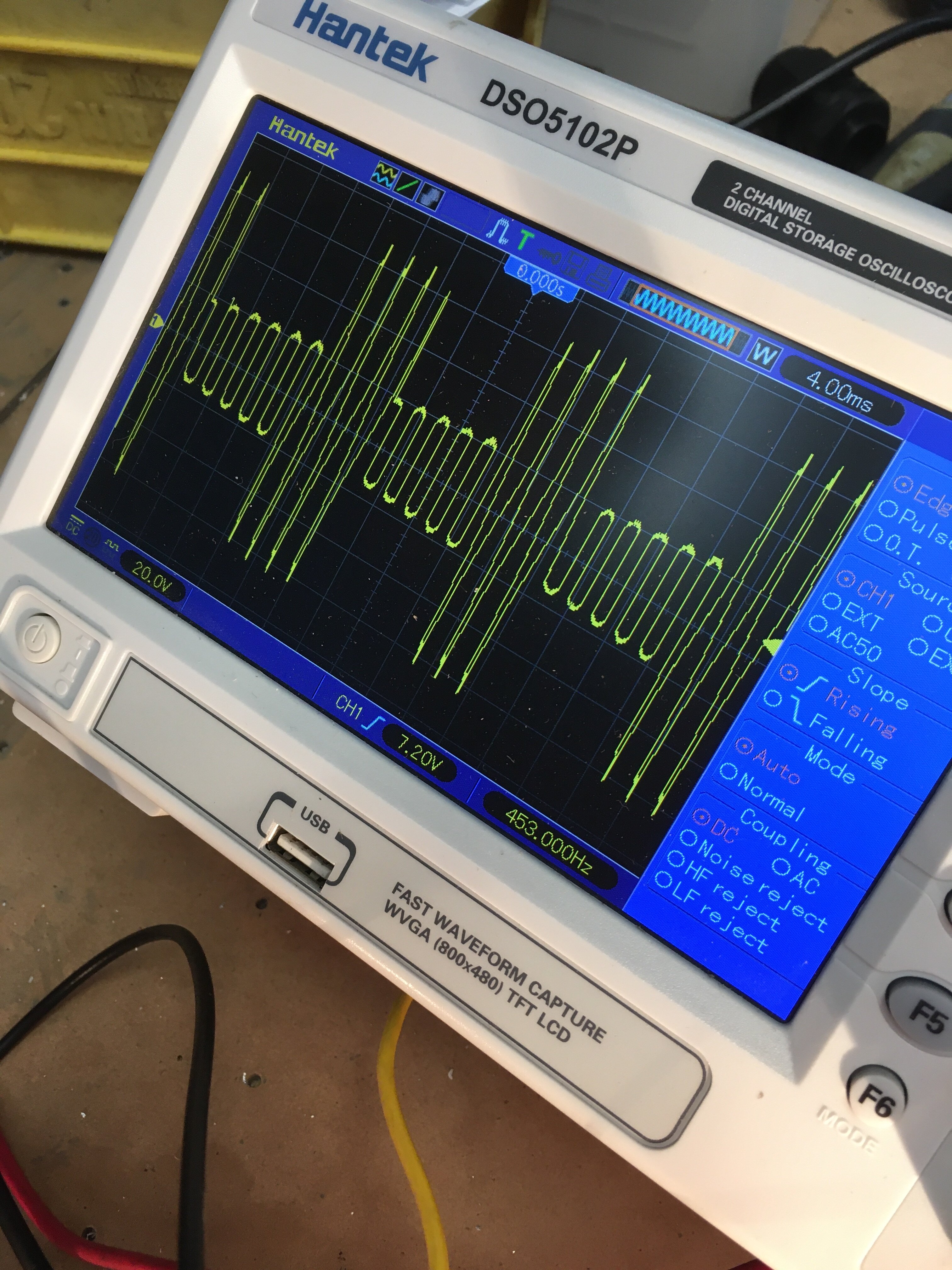

Here is the waveform of one of the first itterations of the new regulator.
As you start to add load to the generator each cycle gets switched to supply the load required. you will see the frequency at the bottom of the display it is decreasing . This is a fixed load on the generator and this is how it switches more of the waveform as the speed of the engine is reduced to be able to supply the load
279044597_IMG_75082.thumb.JPG.17decb381d896882ca4aa217bfd10a63.JPG1834084287_IMG_70892.thumb.JPG.c3a975af750332abc0a23c001f998718.JPG2098766011_IMG_27002.thumb.JPG.02d6042ee36857948ffcb659e160515d.JPG1586155075_IMG_21732.thumb.JPG.10f21d98f39090762d1978a381f853f5.JPG
Link to post

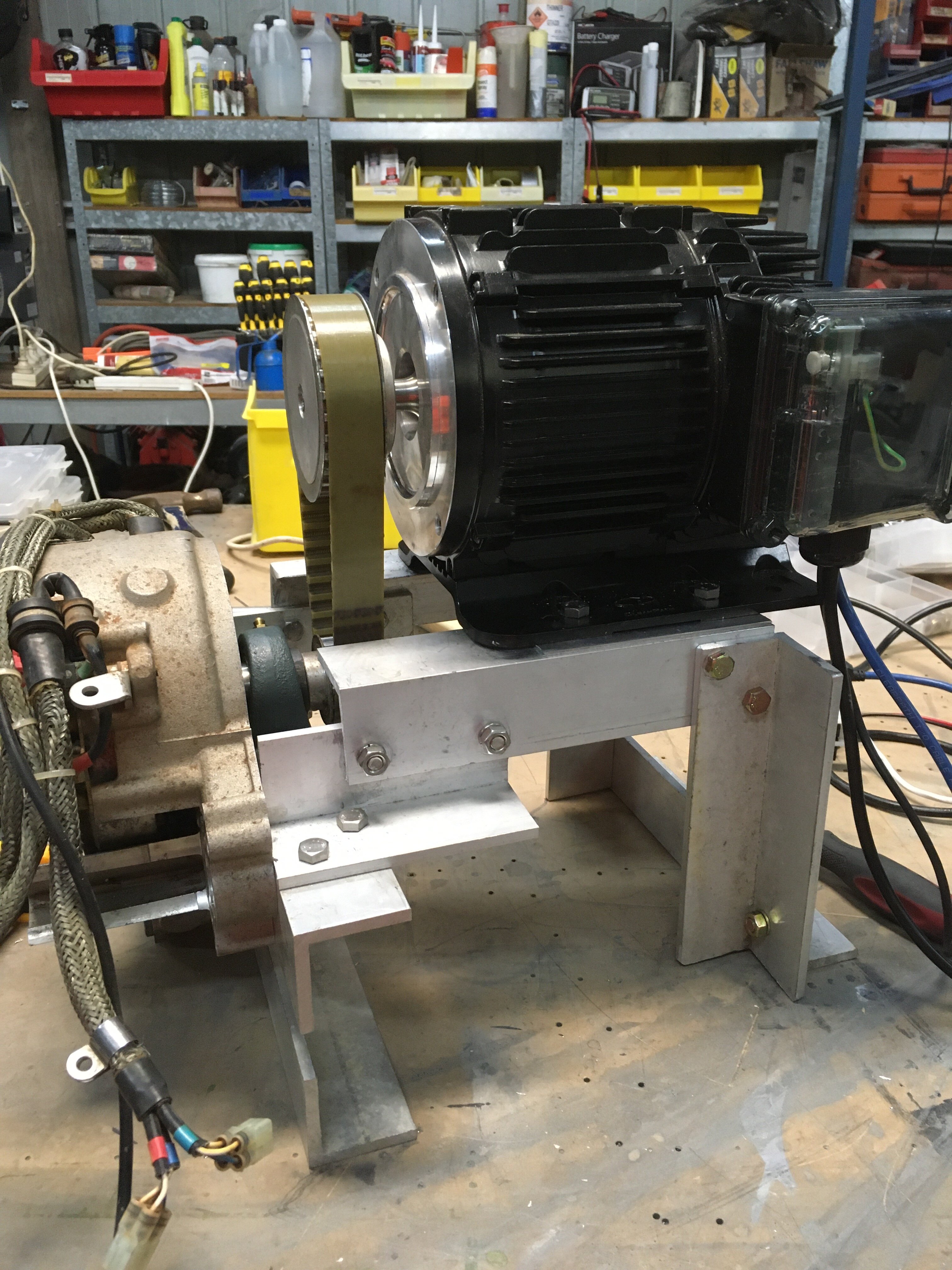

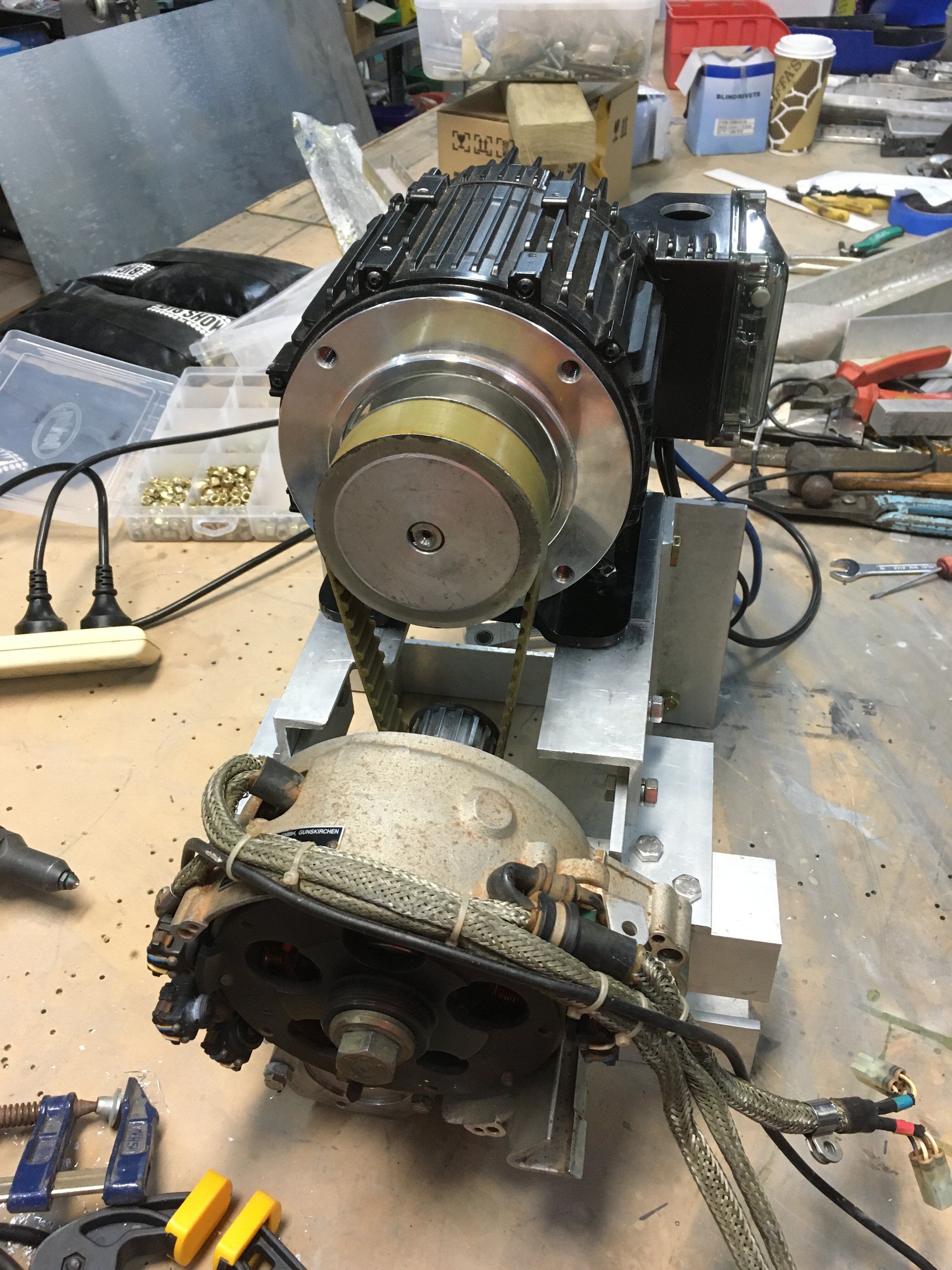

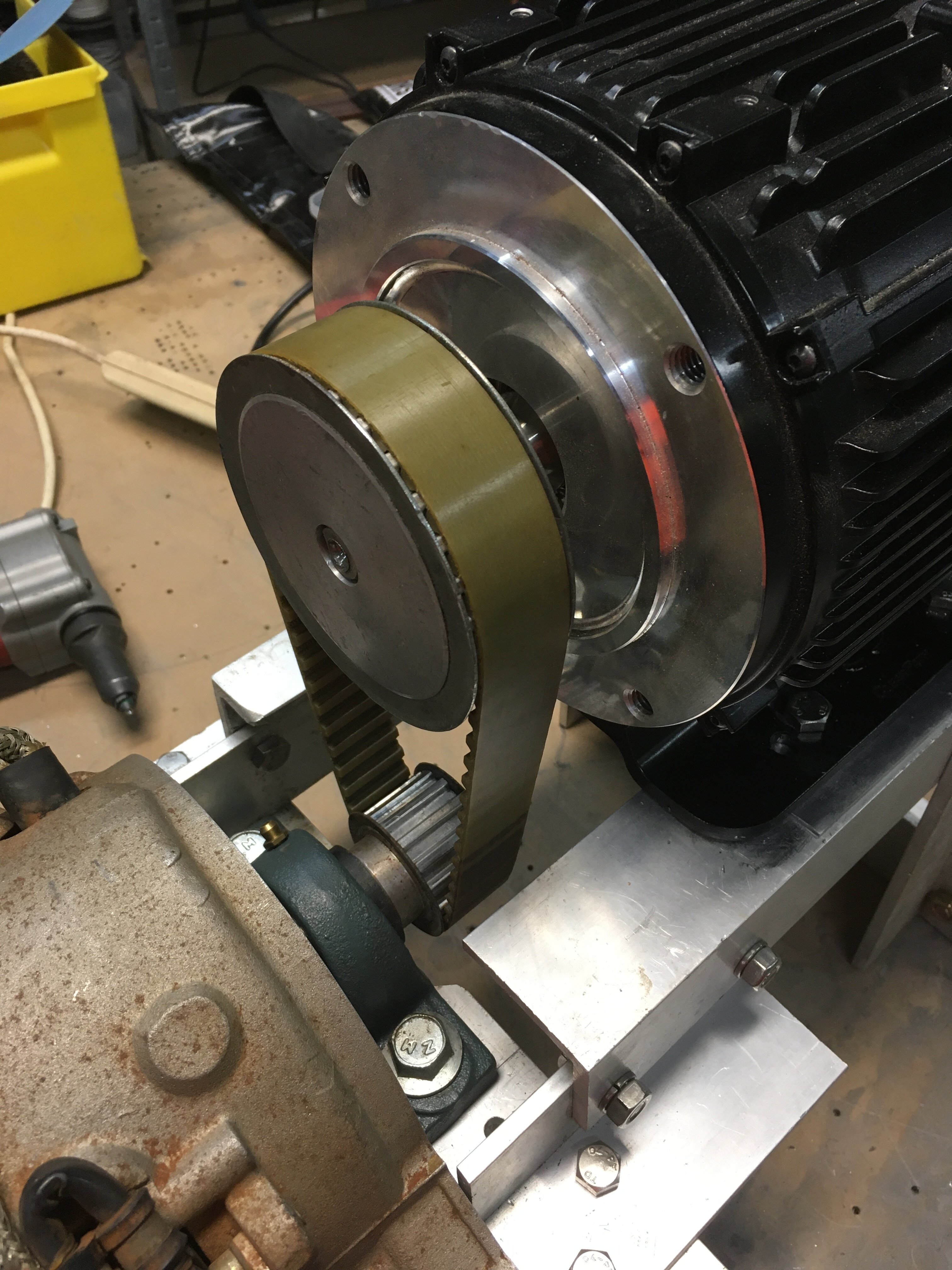

This is the second test rig I made...it is currently being used for the regulator development but will be modified to do my CDI unit testing as well to add to the one I already have for timing checks. This rig is driven by a AC servo motor to be able to get enough grunt to drive the generator to full rpm at full current load
IMG_1244.thumb.JPG.932cba50fb124a8641d49a11b007a2df.JPGIMG_2775.thumb.JPG.599eb7d3918c324acad541ab972d5e15.JPGIMG_7729.thumb.JPG.e899c5d1ec645bde6b5908ac5af7b14c.JPGIMG_5311.thumb.JPG.2acfbc4b49e79ecb6800f06423fb7340.JPG
Link to post
