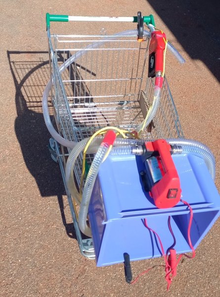

trailer Posted May 17, 2023 Share Posted May 17, 2023 Here's one to take for interest sake (definitely not a recommendation and bound to be controversial) on a trip last year through Victoria I spotted this set up. Uses a $95 ebay diesel/kerosene pump that was being regularly used solely for 98 and avgas in a Cessna. Mounted on an old shopping trolly his jerry cans either in the trolly or ute and Anderson plug on the aircraft to power the 12v pump. Apparently 20l empties in 30 secs, no leaks and works well. Pump, hoses and auto nozzle part of the package. 2 Link to comment Share on other sites More sharing options...
Carbon Canary Posted May 17, 2023 Share Posted May 17, 2023 The red and black clips off the pump look like alligator clips……not an Anderson plug ?? Link to comment Share on other sites More sharing options...
skippydiesel Posted May 17, 2023 Share Posted May 17, 2023 16 hours ago, trailer said: Here's one to take for interest sake (definitely not a recommendation and bound to be controversial) on a trip last year through Victoria I spotted this set up. Uses a $95 ebay diesel/kerosene pump that was being regularly used solely for 98 and avgas in a Cessna. Mounted on an old shopping trolly his jerry cans either in the trolly or ute and Anderson plug on the aircraft to power the 12v pump. Apparently 20l empties in 30 secs, no leaks and works well. Pump, hoses and auto nozzle part of the package. Great ! If it can sustainably pump petrol. My concern would be the seals may deteriorate, over time, when exposed to petrol. When I did my research into small 12V fuel transfer pumps,there were a host of diesel/kerosene types and almost none that were claimed to be suitable for petrol. Link to comment Share on other sites More sharing options...
Carbon Canary Posted May 17, 2023 Share Posted May 17, 2023 I wonder if the pumps listed for diesel/kerosene meet the intrinsically safe requirements versus those listed for petrol ? The 12V pumps advertised for petrol seem to be almost twice the price for an equivalent 12V pump listed for diesel. Diesel is regarded as combustible rather than flammable. (Flash point above ~60C.) Also, is this one powered through an Anderson plug ? The photo looks very much like alligator clips. Link to comment Share on other sites More sharing options...
trailer Posted May 18, 2023 Share Posted May 18, 2023 8 hours ago, Carbon Canary said: I wonder if the pumps listed for diesel/kerosene meet the intrinsically safe requirements versus those listed for petrol ? The 12V pumps advertised for petrol seem to be almost twice the price for an equivalent 12V pump listed for diesel. Diesel is regarded as combustible rather than flammable. (Flash point above ~60C.) Also, is this one powered through an Anderson plug ? The photo looks very much like alligator clips. Can guarantee it's not certified, they are all over ebay etc. There are not many promoted for petrol and those that have the 60l min capacity range are $400 plus. Old mate had another chord which attached to the alligator clips to an anderson plug. Mostly he uses a small battery which sits in the box on the trolly using the alligator clips seen in the picture. 1 1 Link to comment Share on other sites More sharing options...

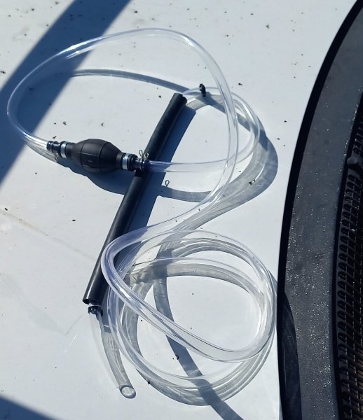

trailer Posted May 18, 2023 Share Posted May 18, 2023 Here is my preferred way to remove fuel from wing tanks if I am not/havent using/used the aircraft for a few weeks. Simple. 2 Link to comment Share on other sites More sharing options...
