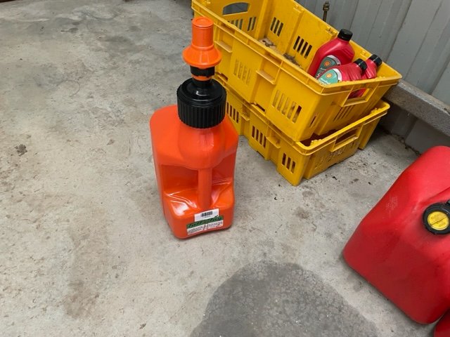

pmccarthy Posted January 5, 2023 Author Share Posted January 5, 2023 This looked like the answer and so I bought one, but the nozzle doesn't fit into the Vixxen or the Foxbat filler. It would, but they have a breather line inside the filler which fouls the nozzle. I tried discharging it manually and got fuel all over the wing as usual! The search continues. 1 Link to comment Share on other sites More sharing options...
