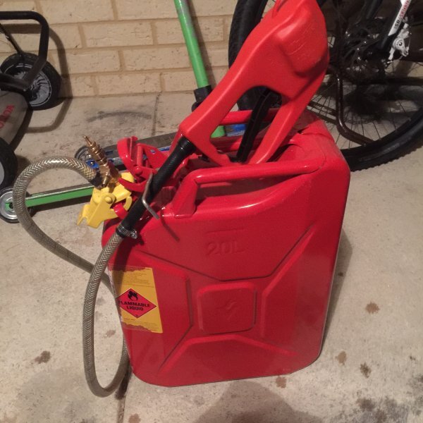

ricky m Posted October 20, 2015 Posted October 20, 2015 Hi metal fits all old army style.. plastic need to match brand of 20litre can.. Here is a pic of mine.. Tanami were great i brought original from a dealer who was no longer a dealer and only had plastic fitting pumps as old stock.. Yet tanami just asked me to return pump i broight and then sent back a pro version for metal cans...
ricky m Posted October 20, 2015 Posted October 20, 2015 My tank is on the side and that does make bit of pain as cant get full flow with with the small travel mr funnel i use.. so have to balance pressure from pump and triger control to stop funnel over flowing (would be embarasing reporting a fuel spill to the enviro department at YPJT !!!as i am one of the reporting officers there ....lol!!! hence y strugling to lift and pour fuel was not an option). Still since jabiru now advise only keeping mogas for two weeks i have been using avgass for last six weeks (ish).. :( :) so it makes great mower can ....(dont say a word the wife said enough)
matt walsh Posted October 20, 2015 Author Posted October 20, 2015 Ricky M , yes a fuel spill would be embarrassing and another act for Jabiru dislikers to waggle their fingers against!!!! Re your comment on balancing pump pressure and nozzle control, is your procedure; pump up the jerry can to certain pressure or no's of strokes of pump, then operate the nozzle and discharge the fuel into funnel. When it ceases to flow ie pressure lost then nozzle off and re pressurise and repeat cycle??? I note your Perth address. Have you flown to Rottnest Island? I went over in a VH Cessna and it was pretty interesting landing.

IanR Posted October 20, 2015 Posted October 20, 2015 Quote Tanami pump works a treat for me too. No power problems as I use a small foot pump - good for out bush - lightweight - no static problems either. The hose can be inserted into a filter funnel if you like. I needed 3m hose to have some slack on a Brumby high wing. It takes me just under 2 mins to transfer 20L PULP from ground level into the aircrafts tank. Sure beats juggling a jerrycan while perched on a stepladder. I also use a Tanami pump - and incorporated a filter in the hose - works fine

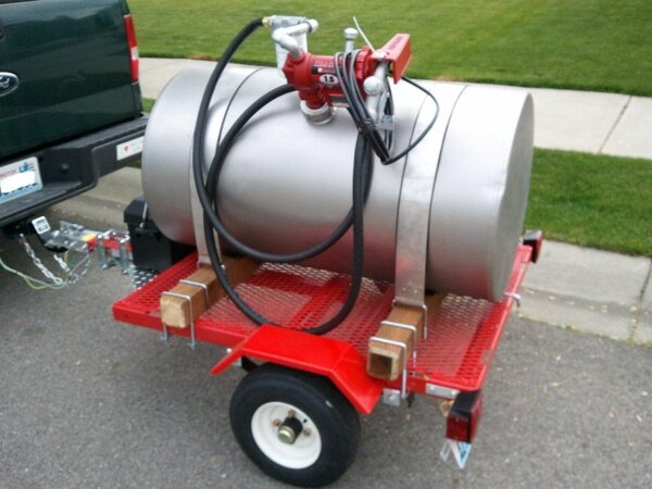

Peter G Posted October 21, 2015 Posted October 21, 2015 I was wanting to make this setup but reading all your posts do you think its going to be ok to fill from a servo and use in Aus? the only difference I was going to use the $400 blue unleaded fuel pump I see on ebay like Mark posted the link to.. The Tank I was thinking of buying a Truck fuel tank and not making one or using a 44gal the Pic was from a bloke in USA 1

matt walsh Posted October 21, 2015 Author Posted October 21, 2015 Quote I also use a Tanami pump - and incorporated a filter in the hose - works fine Ian, what's your nozzle arrangement at the end of discharge hose? Do you insert the hose directly into fuel tank? do you have a tap or valve to control flow once the jerry can is pressurised?

matt walsh Posted October 21, 2015 Author Posted October 21, 2015 Quote I was wanting to make this setup but reading all your posts do you think its going to be ok to fill from a servo and use in Aus? the only difference I was going to use the $400 blue unleaded fuel pump I see on ebay like Mark posted the link to.. The Tank I was thinking of buying a Truck fuel tank and not making one or using a 44gal the Pic was from a bloke in USA Hi Peter, the portable fuel tanker and pump looks a ripper. My understanding about fuel quality if that it goes "off" or loses some of its octane rating if stored for several weeks and that fresh fuel is always preferred. I'm curious if pilots refuelling from tanks or 44 gal drums, consume that much fuel in weeks? if not, is the fuel sitting in the tank for long period. Maybe this is not an issue and I'm just interested as I it would take me 2-3 months to use 200litres of PULP. 1

IanR Posted October 21, 2015 Posted October 21, 2015 Quote Ian, what's your nozzle arrangement at the end of discharge hose? Do you insert the hose directly into fuel tank? do you have a tap or valve to control flow once the jerry can is pressurised? I just have the basic pipe with the inline filter. As its only 20 litre cans I just need to be careful - and with the pressure relief valve its easy to cut off. I don't have over-wing tanks though.
lyle janke Posted October 21, 2015 Posted October 21, 2015 Quote I was wanting to make this setup but reading all your posts do you think its going to be ok to fill from a servo and use in Aus? the only difference I was going to use the $400 blue unleaded fuel pump I see on ebay like Mark posted the link to.. The Tank I was thinking of buying a Truck fuel tank and not making one or using a 44gal the Pic was from a bloke in USA hi i have something similiar on drawing board instead using 200lit drum . the pump used if it is an e-bay issue is not sealed & is advertised as diesel only . the blue e-bay model is listed as suitable for petrol but has a disclaimer "not to be used to pump avgas" what is the difference to normal fuel?? or is it a legal issue what would 1 need to to modify to overcome legal issues for private use ? the only issue that come to mind immediately is static /earthing issues with pump/installation . the pump already has an extra threaded hole on body of pump so i thinks manufacturer already uses this pump in an aviation environment elswhere . my research so far identifies the main delivery fuel hose also as being an issue . is the e-bay version suitable for an aviation environment & able to disperse static build-up maybe change hose to suitable version & create earthing to unit & problem solved any thoughts as to whether i`m on right track any aviation units i`ve found are more than double the price & make the task of refuelling not cost effective any more for the casual flyer who wants to get away from fumbling with gerry cans lyle 1
Peter G Posted October 21, 2015 Posted October 21, 2015 Quote Hi Peter, the portable fuel tanker and pump looks a ripper. My understanding about fuel quality if that it goes "off" or loses some of its octane rating if stored for several weeks and that fresh fuel is always preferred. I'm curious if pilots refuelling from tanks or 44 gal drums, consume that much fuel in weeks? if not, is the fuel sitting in the tank for long period. Maybe this is not an issue and I'm just interested as I it would take me 2-3 months to use 200litres of PULP. Hi Matt, yes it sure it a nice set up, I was looking at doing that for ease of use as I'm in a wheelchair and I cant lift 20lt fuel drums let alone the pain in ass job of filling up 3x separate 20lt tanks then driving them in my boot to fuel up my plane.. having the trailer setup for me is easy to full up at the servo then fill my plane same as at a bowser filling my car so for me its so easy.... I hear ya on using a 200lt tank with fuel going off but the club here in bendigo have the same set up with what looks like a 2000lt tank and It gives no issues of fuel going off in the club planes... As long as it has a good fuel filter system its a safe way to carry fuel and fill my wings up.. The semi tanks I was looking at using are about 200lt but it would still be a great setup with a smaller 100lt tank for 1-3 weeks of flying and I guess it depends on how often we have time to fly :) anyway its the setup I will be making for sure, I have the trailer already and just have to sort the Tank, pump, battery and glass filter and its happy days lol I kind of got of the subject question on the rotary pump but reading everyones input I wanted to ask the question for some feedback on the idea and was thinking of a rotary pump instead but settled for the easyer ep pump. for me its to do things easy rather than struggle and spill fuel on myself trying to lift it... haha Pete
