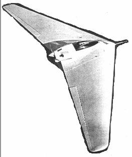

Directional stability, and the need for vertical devices for said stability is dependant on wing sweep.
The more rearward sweep, the less need for vertical surfaces.
Swept forward to straight flying wings need vertical surfaces, by the time you get to around 30º sweep back, no vertical surfaces are really needed, especially if there is any dihedral still present.
Winglets on a swept flying wing would actually be counter-productive, unless they actually turned down.
All these variations do and have existed, as well as those that technically didn't need tip fins (or winglets).
And an example of a swept flying wing that probably didn't need tip fins,
But as some here would say, it looked cool....
Directional stability, and the need for vertical devices for said stability is dependant on wing sweep.The more rearward sweep, the less need for vertical surfaces.

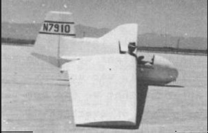

Ah but you overlooked the point on efficiency - and the SB13 with the swept wing and tip fins is the not to look cool but to provide the range of efficiency.
To explain on flying wings:
with straight wings twist cannot balance 1/4 chord moments of the section or variance of CofG/Coflift ... you need low moment sections (unless pendulum stability is used eg parachutes/paragliders) and use of elevons/elevators is inefficient as it needs to kill lots of lift to get a average pitch change due to the wing running on 1 span line - no tail effect
With rearswept wings you get the displacement of the elevons/elevators outboard are displaced behind the rest of the sing and you get effective tail ... and with use of geometric or aerodynamic twist you can balance out both the Cm from the wing section and the moment from the CofG/Coflift displacement ... and the added bonus is that the 'twist' out at the tips is behind the CofG and acts as a tail in terms of directional stability ... but it costs.
High twist gives solid directional stability but has drag at all angles of attack and worsening drag as you move away from the design point for the twist.
Use of minimal twist to aim for your design point of speed/CofG may lead to very low directional stability and use of winglets to add directional stability can provide the stability at lower drag than twist does ... and the drag increases as you move away from the design point with winglets are substantially lower than the drag from having enough twist for stability at design point and then flying away from that design point.
That's exactly what the SB13 (last pic) was testing - how to optimise a swept wing for a design point and have lower drag when operating away from that design point to be competitive with standard class 'normal' tallied gliders

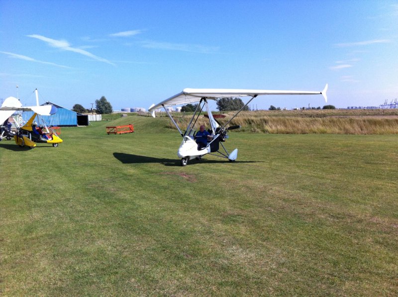

And this can be seen even in human carrying flying wings that do exist ... this wing/trike setup had absolutely neutral directional stability without the ting tip - it was a vomit comet but add the wing tips and it became like a train on rails and lost no measurable speed ... trike have enough drag to rarely see tip effects.
And these tips were made by me with two additional goals in mind:
1. Same tip left/right so less mold making
2. cranked 'seagull' setup - because its cool and unusual
the added bonus was that when you took the wingtip off (Velcro to the inside of the upper/lower skins onto a wedge molded into the tip) it was weighted to actually fly as a chuck glider ;-)

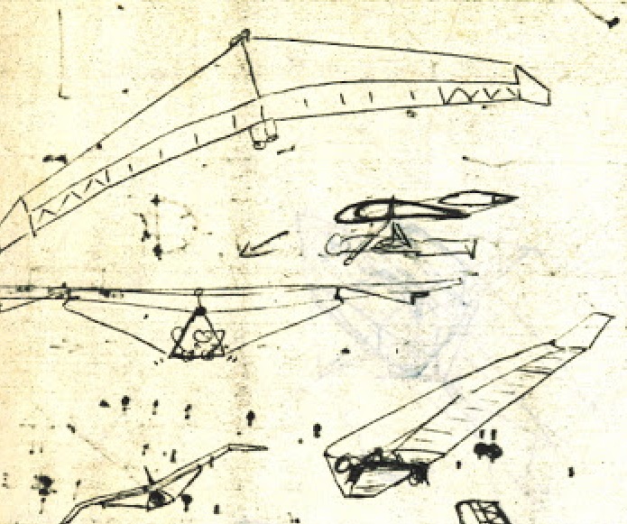

I think I can picture what you're going to do, I was going to go a different way back in my hang gliding days, with a high aspect rigid I wanted to build.
I think some one else may have tried it already somewhere, where ailerons (only, as pitch is ok via weight) were connected to a floating lift cable system, that was then linked to the aileron belcranks.
This meant that it still had the A frame 'wiggle' modern kites have, but the wiggle drove the ailerons instead of the crossbar.
I later realised that this could run away with itself, so the ailerons needed to be mass balanced, and maybe even have anti-servo tabs.
I think I can picture what you're going to do, I was going to go a different way back in my hang gliding days, with a high aspect rigid I wanted to build.I think some one else may have tried it already somewhere, where ailerons (only, as pitch is ok via weight) were connected to a floating lift cable system, that was then linked to the aileron belcranks.

LOL - yep you figured exactly the same as me - they need to reverse throws to prevent runaway - or as you suggest have antiservo tabs to prevent runaway ... and other than having more mass further out and rearward I would have considered using antiservo tabs instead of reversing kinematics in my drawings.
On your bar wiggle running ailerons there are several rigid wing hanggliders that use bar wiggle for spoilers - easier/lighter to build than ailerons.
