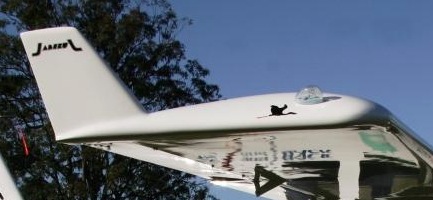

pylon500 Posted April 16, 2016 Share Posted April 16, 2016 Unfortunately, I doubt that the winglets fitted to the jabiru's do anything useful at all... They are too thick, have the wrong section, and have been fitted to a wingtip that is already using a totally different aerodynamic technology, ie; turned down Hoerner style tip. 1 2 Link to comment Share on other sites More sharing options...

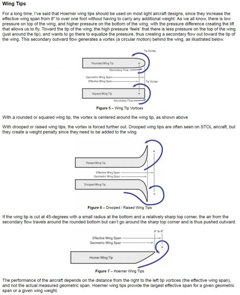

Soleair Posted April 17, 2016 Share Posted April 17, 2016 . . . . turned down Hoerner style tip.[ATTACH=full]42484[/ATTACH] The term 'Hoerner wingtip' has become generic, it seems, to all modified tip profiles. But to be accurate, a Hoerner wing tip is not turned either up or down - it is level. See item 5 in the definition below, from this link: Dr. Hoerner showed that the efficiency of a wing tip depends on six critical areas. His findings were: 1. The tip must be as thin as possible but still maintain a round leading edge. 2. A blending of wing top and bottom surfaces along a straight line. 3. The edge formed at this blend to be as thin as possible. 4. Obtain a sharp trailing edge leading to a corner, this corner to be in a straight a line as possible with the entire wing trailing edge. 5. The top of the tip to remain in a level plane with the top of the wing. 6. The bottom plane to be brought up in a convex curve. Wingtips which project up or down ISTR were developed by Richard Whitcomb at LRC in the 70's, so presumably should be called Whitcomb tips. A.Pedant 1 1 Link to comment Share on other sites More sharing options...

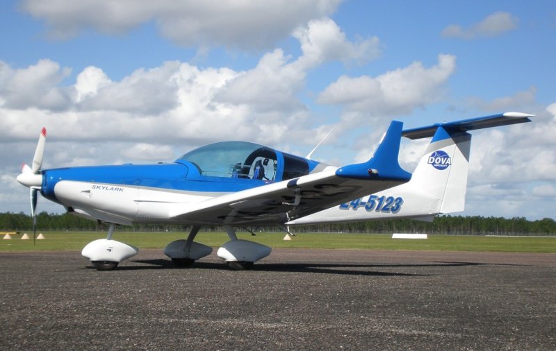

Mick Posted April 17, 2016 Share Posted April 17, 2016 Performance is nice, but looking good is more important? Life is too short to fly ugly aeroplanes! My Skylark has really big winglets ( by LSA standards ), in a review on the aircraft by an American magazine their comment was "The Skylark's winglets are either an efficient aerodynamic device or a clever marketing ploy, but either way they work!" I have done some research on the design and from what I can find the design is correct to reduce tip vortices. As for how much difference they make? As I have not flown a Skylark without them I couldn't tell you. 1 Link to comment Share on other sites More sharing options...

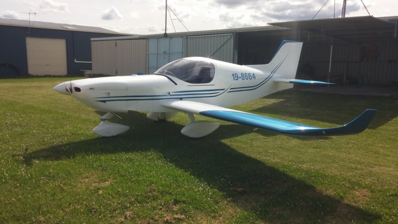

kgwilson Posted April 18, 2016 Share Posted April 18, 2016 I remember Garry Morgan telling me he spent more than 2 years experimenting with the winglet design for the Sierra resulting in enhanced performance, turn stability and reduction in stall speed. The Jab 3300 powered Sierra has a 75%power cruise of 130 knots, a clean stall of 37 knots & 32 knots with full flap. The winglets are blended into the tip. See photos below Link to comment Share on other sites More sharing options...
