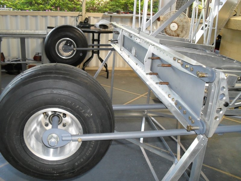

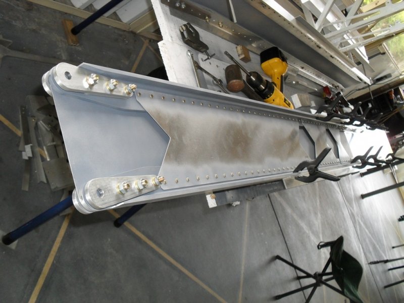

bexrbetter Posted July 5, 2016 Author Share Posted July 5, 2016 The general idea of your carry-through is OK but I'm a bit concerned about some of the details. By the way, I was in a bit of a hurry today and don't want to be seen as coming off short on HITC's well reasoned and technically correct input (relative) - as usual. I am still fiddling, the structure is incomplete (hell I only decided on Saturday night and I had something to show on Monday!) and HITCs material and sizings were well off what I am using, but otherwise I couldn't think of a airplane or pilot that I would feel more safer in than one designed, built and piloted by HITC, his admirable record in aviation stands and his writings on any subject to do with homebuilding are always to be respected and I wish I had a 1/10th of his hands on real world experience. Also every bit of aluminium you see is 6061, either T5, extrusions, or T6, sheet, and the stainless is 316, this ain't a Bunnings build. 8 1 1 Link to comment Share on other sites More sharing options...
Head in the clouds Posted July 6, 2016 Share Posted July 6, 2016 Well - thanks for the kind words. I'm quite sure that my guesstimate of the material sizes you've used for the carry through are not likely to be exact, but I still think they look a bit light ... I notice you've not said what the actual sizing is though. On closer inspection of your photos the caps are a little larger than I first thought but I'd be surprised if they're larger than 50x3 angle and since you say it's 6061T5 then at a yield strength of 210MPa they'd calc out at 21.77kg/sqmm and have a cross-sectional area of 291sqmm, giving them a capability of 6.4T - which is still only about half what you need. I'm not meaning to rain on your parade but I really think you need to build the whole carry through on the bench before 'inserting' it through the fuselage. Your photos show that you've riveted it into place via pop-rivets to the angles each side of the fuselage - that's a nice simple attachment method BTW, and quite secure enough since it can't 'escape' vertically, so only needs to be held in location laterally - but if you do plan to solid rivet the web then it'd be much easier bucking it on the bench than trying to do it in-situ. If you use pop rivets you'll be building a very limited service life airframe, they'll work loose in a short while in that highly stressed location. Just for reference I've posted some pictures below of the carry-through I used on AussieMozzie which I never completed, but which is a similar wing arrangement for a pretty much identical weight aircraft. If you compare the size of the structural members you'll see why I think you might be a bit on the light side. Note that on this carry-through I have tapered the spar cap material at the outboard ends where the load is transferred from the aly caps to the nearly 800MPa heat-treated chromoly wing attachment plates, so to compare the actual member size you need to look at the carry through near its centre rather than at the ends, but as you can see, the spars for a cantilever wing need to be quite massive, even when using 6061T6 alloy - 2 1 Link to comment Share on other sites More sharing options...
Marty_d Posted July 6, 2016 Share Posted July 6, 2016 Well - thanks for the kind words.I'm quite sure that my guesstimate of the material sizes you've used for the carry through are not likely to be exact, but I still think they look a bit light ... I notice you've not said what the actual sizing is though. On closer inspection of your photos the caps are a little larger than I first thought but I'd be surprised if they're larger than 50x3 angle and since you say it's 6061T5 then at a yield strength of 210MPa they'd calc out at 21.77kg/sqmm and have a cross-sectional area of 291sqmm, giving them a capability of 6.4T - which is still only about half what you need. I'm not meaning to rain on your parade but I really think you need to build the whole carry through on the bench before 'inserting' it through the fuselage. Your photos show that you've riveted it into place via pop-rivets to the angles each side of the fuselage - that's a nice simple attachment method BTW, and quite secure enough since it can't 'escape' vertically, so only needs to be held in location laterally - but if you do plan to solid rivet the web then it'd be much easier bucking it on the bench than trying to do it in-situ. If you use pop rivets you'll be building a very limited service life airframe, they'll work loose in a short while in that highly stressed location. Just for reference I've posted some pictures below of the carry-through I used on AussieMozzie which I never completed, but which is a similar wing arrangement for a pretty much identical weight aircraft. If you compare the size of the structural members you'll see why I think you might be a bit on the light side. Note that on this carry-through I have tapered the spar cap material at the outboard ends where the load is transferred from the aly caps to the nearly 800MPa heat-treated chromoly wing attachment plates, so to compare the actual member size you need to look at the carry through near its centre rather than at the ends, but as you can see, the spars for a cantilever wing need to be quite massive, even when using 6061T6 alloy - [ATTACH]44131[/ATTACH] [ATTACH]44132[/ATTACH] [ATTACH]44133[/ATTACH] HITC, in the far future when I design my Spitfire, I would love to seek your opinion on some design aspects! 1 Link to comment Share on other sites More sharing options...

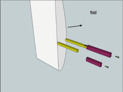

bexrbetter Posted July 12, 2016 Author Share Posted July 12, 2016 Thanks Marty. Bored hanging around with my sore hand today so here is a gif of the wing fold using simple tube and a heim joint .. or rose joint if you're British. The Heim company in America took a licence to produce them in the US while the Rose company did so in the UK in case you were ever wondering. 3 Link to comment Share on other sites More sharing options...
AussieB1rd Posted July 12, 2016 Share Posted July 12, 2016 so here is a gif of the wing fold using simple tube and a heim joint Pretty sure a square peg in a square hole wont work, here is a thread relating to some wings folds and a sonex think the first one maybe just what your looking for, or like the other sonex, make the wing root part of the fuse and just fold vertically, if was ok for FU4 Corsair then it should be ok for this lil baby. Folding Wing Modification for a Sonex--considerations Link to comment Share on other sites More sharing options...
