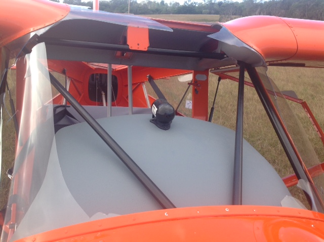

dan3111 Posted November 30, 2016 Share Posted November 30, 2016 I haven't heard of this at all but there is nothing unusual about the windscreens in foxbats I've had 2 and no problem I think u have a bit of bat envy. Reply Well Brace your self ozbear It happened to a friend the had a student on board when it let go his head sets blew off doors blew out then wraped around struts. It pitched nose down had to use full back stick with engine idle just to maintain a glide . Had a forced landing hard in paddock as no more back stick to flare with . So sorry you can have your bat envy let me know how you get on if it happens again to some poor guy . Sorry we don't learn anything in this sport from near death counts . 1 Link to comment Share on other sites More sharing options...

storchy neil Posted November 30, 2016 Share Posted November 30, 2016 Thank you dan that windscreen peeled up from the bottom other wise the pilot would not have a head Bloody lack of good governance of maitanance Failure of reporting that if I am right the owner should be sent a very nasty letter and not to fly that aircraft Neil Link to comment Share on other sites More sharing options...

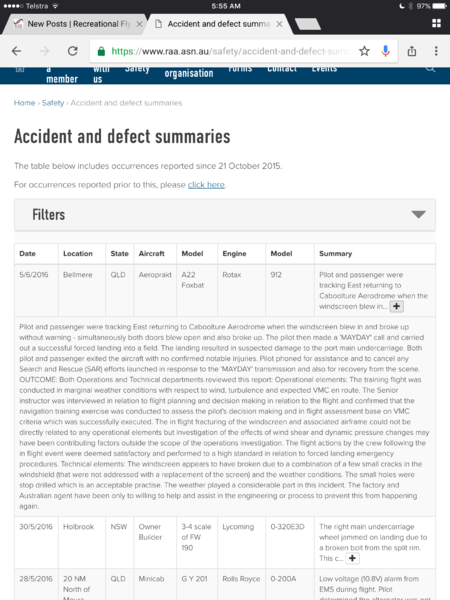

corvairkr Posted November 30, 2016 Share Posted November 30, 2016 fair dinkim you blokes if you want to know if it has been reported just have a look on the RAA website ...took about 5 minutes 3 2 1 Link to comment Share on other sites More sharing options...

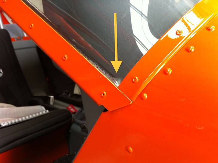

ozbear Posted November 30, 2016 Share Posted November 30, 2016 It plainly states pre existing cracks as to how bad they were is open for conjecture are you neglecting giving us that part of the information on purpose to soil the name of a good aircraft or are you ignorant of that fact Dan Link to comment Share on other sites More sharing options...
motzartmerv Posted November 30, 2016 Share Posted November 30, 2016 Pre existing cracks. Classic example of "normalisation of deviance" it seems. 1 Link to comment Share on other sites More sharing options...
dan3111 Posted November 30, 2016 Share Posted November 30, 2016 Thank you dan that windscreen peeled up from the bottom other wise the pilot would not have a headBloody lack of good governance of maitanance Failure of reporting that if I am right the owner should be sent a very nasty letter and not to fly that aircraft Neil It's like this storchy Things do get reported then they go into Black file file the same one one that lost all the rego info , now when a aircraft lands in a Ferris wheel for a ride with out paying mind you . Mr CASA has quick check and starts kicking bums . What has changed since then .? They wouldn't think just to let owns of type a quick email just to check items as reports come in . 1 Link to comment Share on other sites More sharing options...
JimG Posted November 30, 2016 Share Posted November 30, 2016 Pre existing cracks. Classic example of "normalisation of deviance" it seems. Would suggest operating that aircraft is a willing deviance from a regulation or at the very least a safe practice. This is absolutely not the case ! The Tech Dept response to this 'closed case' is contradictory . The report reads ' The small holes were stop drilled which is an acceptable practise. ' also '(that were not addressed with a replacement of the screen)' . The FACTS are this , when the aircraft was new and still under warranty very small cracks were noticed within days of taking delivery of the aircraft, the importer was notified , in a relatively short time the cracks had grown but still very small , again the importer was notified , advise was given and the L2 who does the regular service and maintenance of the fleet then stop drilled them IAW the current foxbat maintenance manual. there is no 'normalisation of deviance' going on here. The Owner was never happy with this and even though the cracks had stabilized, the aircraft had a booking the very next day to have the windscreen replaced, but obvious a day too late . ozbear , Dan is well aware of the facts and the report has been on the RAA website since a few days after the incident date 05/06/16. Jim G Link to comment Share on other sites More sharing options...
dan3111 Posted November 30, 2016 Share Posted November 30, 2016 If you go to any fly in you see a lot worse then this even in GA air craft . Yes screen show small craze in corners plane was under two years old . How ever with the design there no support in the middle centre tubes going down like a lot of aircraft so screen is like a car just held around edge . So under big stress a weakness any where and all over red rover with only 2mm poly carbonate . Craze also folks can happen any time any where so there is no redunency in design . Link to comment Share on other sites More sharing options...
motzartmerv Posted November 30, 2016 Share Posted November 30, 2016 I would suggest that cracks in a new windscreen is far from "normal" and would be considered a deviance. The resulting failure certainly leads one to think the stop drilling was a bandaid that did not work. Normalization of deviance is not only applied to the operator, but the manufacturer also if they were prepared to allow stop drilling in a new windscreen as a means. 1 2 Link to comment Share on other sites More sharing options...
