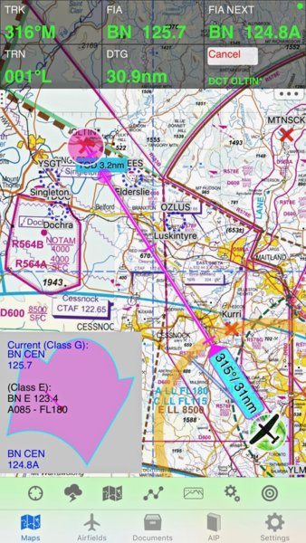

Of course, now we can get help keeping up with Area frequencies using the
FIA / FIA NEXT fields on our EFBs
(and/or the pinkish Area-freq map insert as on this iPhone OZRWY screenshot)

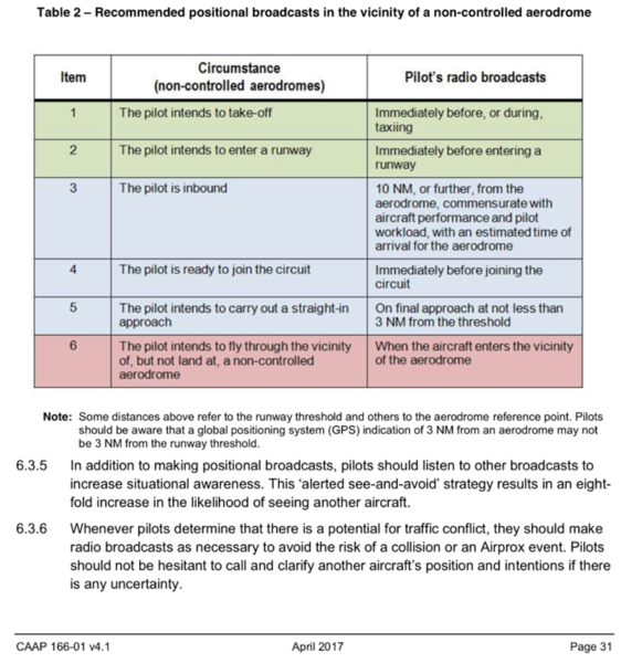

There was little or no discussion or reported issues that I could see before CASA changed it a while back without consultation which suggests to me that was the optimum at the time so they should simply revert to that.
Getting out the map to work out what area frequency is is usually the last thing one remembers. Just because something is done in the calm doesn't mean that it is a good idea when one is desperate.

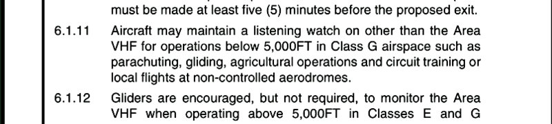

Really?
Apart from being easy and simple it also a requirement..
This is how the ENR 1.1 - 48 / 6.1.11 (17 AUG 2017) puts it.
I suppose what might be added to that 'such as' list is cross-country flights in VFR / Class G which remain within 20nm of any CTAF or other uncontrolled ALA. Which for a lot of the Oz J-curve would be most places.
In any case, I suppose Col's point is that one could find oneself making an entire cross-country flight without being required to listen to Area (in fact, required not to - absent a dual watch radio) which, in an emergency (no time to dial in the FIA) would likely have your call for help fall on absent ears.

I think alot of the push for 20NM comes from faster aircraft, IFR, and rpt getting on the CTAF earlier and giving more warning.Something fast "inbound on descent" can be in the circuit frighteningly quick....
I agree. I often hear the FlyDoc, Rex and others making 20 mile calls. If I'm inbound to the same airfield, it gives me time to talk to these pilots and sort out our arrival with theirs. I find that these commercial pilots are more than happy to talk to us bug smashers and find out where we are and how high etc. They travel "frighteningly quick" as Downunder so aptly said, and they can be on top of you before you can spot them coming. Also, this is another reason I have a mode S transponder in my plane. Anything that makes me visible to the high speed traffic is worth the investment, IMO.

Gary, that got me thinking about another drawback to CASA's plan. With this plan, we not only have to keep our situational awareness for frequencies horizontally, but vertically too. So if I'm sloping along at 3,500' heading East and the bumps come up and I want to climb out of them, I now have to remember to switch from 126.7 to Area as I climb through 5,000'?

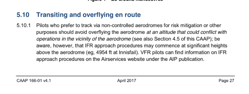

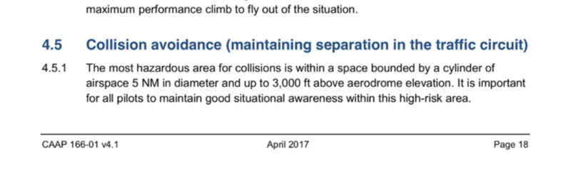

Does anyone know how high the CTAF airspace extends above an uncontrolled airfield??
I understood that is is 3000' AGL, but I don't know where or if it's written....
The reason I ask is that I often hear aircraft overflying my home field at Kilcoy (alt 400') and announcing that they are approaching and overflying at 3500', direction, intentions, etc, etc.... An aircraft at that altitude is of no interest to me at circuit or approach altitude. But a radio transmission from that altitude carries widely, to Tyagera, NSW and way north of Gympie, and so ties up MULTICOM radio time for a wide area that also has no interest in the content. Seems to me that when flying x-country at 3000' AGL or above we would be best to not clutter the airwaves with such 'overflying' broadcasts......

Tutorial: VHF communications — R/T procedures
An aircraft is 'in the vicinity' of a non-controlled aerodrome if it is within a horizontal distance of 10 nautical miles from that aerodrome and at a height above the aerodrome that could result in conflict with operations at the aerodrome. The height dimension of the aerodrome's airspace is a rather nebulous concept — few light aircraft pilots would be familiar with the potential flight path profiles of fast-moving RPT aircraft conducting their normal 'straight-in' or 'circling' approaches or their climb-out; so the upper and lower 'vicinity' limits (at various distances from the airfield with allowance for terrain elevation) are difficult to judge. Perhaps 5000 feet amsl could be regarded as the height limit of the airspace at most CTAF aerodromes – but aerodrome elevation must be taken into account.
CAR 166 C
Yes, good point JG3, I also had the figure of 3,000' in my head but all I can find now in the CAAPs are these 'recommendations' and use of the word 'vicinity'.
