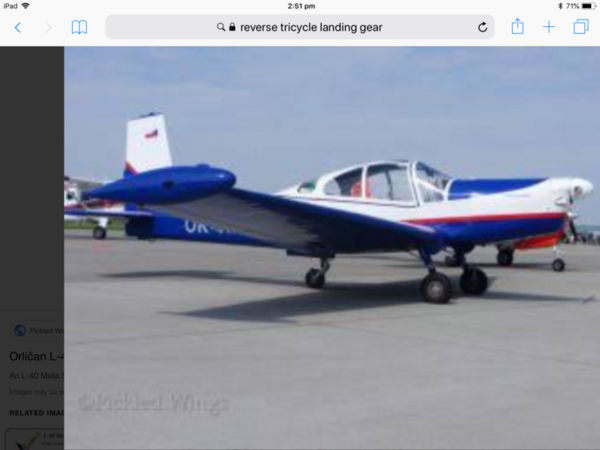

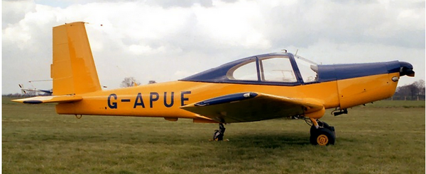

Jaba-who Posted August 5, 2018 Share Posted August 5, 2018 IF the mains are forward of the C of G it's a taildragger.. The attitude it sat on the ground. .....snip..... . Nev I’m not sure that’s true. The Sokol pictured earlier clearly must have the c of g behind the mains otherwise it would be sitting bum up, nose down, prop kissing the tarmac. But seems everyone has been happy to say its not a taildragger. Link to comment Share on other sites More sharing options...

M61A1 Posted August 5, 2018 Share Posted August 5, 2018 I’m not sure that’s true.The Sokol pictured earlier clearly must have the c of g behind the mains otherwise it would be sitting bum up, nose down, prop kissing the tarmac. But seems everyone has been happy to say its not a taildragger. Do you reckon then that you could put Joe Average Cessna driver in it then and they would handle it ok? Link to comment Share on other sites More sharing options...

facthunter Posted August 6, 2018 Share Posted August 6, 2018 Jaba- who. What they marketed it as is anyone's guess. They may have claimed it overcame "some" tailwheel problems. I have flown one , when they were new and it was a demonstrator and I have a friend who still has one. I started flying on tailfdraggers so It was no deal.. You just had to be careful you didn't land with the tail too low and put to much weight on the "rear " wheel. A mustang is not much different. and quite a few warbirds. I'll still stick to my definition happily. Where are the "everyone's" who say it's not a taildragger. Taildragger is a colloquial term any how. It's where the mains are that matters. Nev 1 Link to comment Share on other sites More sharing options...
