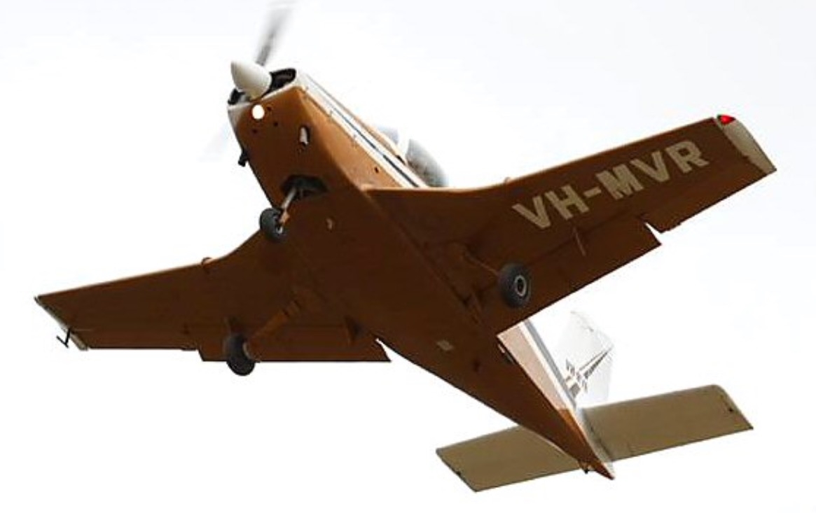

Old Koreelah Posted November 29, 2018 Share Posted November 29, 2018 ...Buying a Victa Airtourer really did bring the benefits of sideslipping to the fore. Cleared for a full flap sideslip up to 87 knots it gave a remarkable versatility to approaches, with great control authority... The CT-4 is a development of the Victa and lots of them operate locally. I've read that their triangular leading edge extensions (actually fuel tanks) have improved stall performance. That's one modification I am considering to improve my Jodel's stall behaviour, but I need to hear from people who know this well. Link to comment Share on other sites More sharing options...
djpacro Posted November 29, 2018 Share Posted November 29, 2018 Henry used to tell us that the whole wind/tunnel shook when the model stalled! The prototype had a violent uncommanded roll which was fixed by the wing fences. Seems to me that those cuffs were too large. I have a copy of the Aircruiser W/T test report. I’ve used smaller wing root cuffs successfully. As an example take a look at the T-34C. 1 Link to comment Share on other sites More sharing options...
