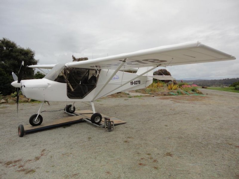

IHC150 Posted May 10, 2019 Share Posted May 10, 2019 Here's one I made myself recently with built in pivoting ramps and chocks to stop the aircraft rolling off. Works well, but might not suit your situation if you don't have much space to roll the aircraft on. The tail wheel sits on a prefab movers trolley with castors bought for about $20 from Bunnings. I just cut a slot in the craftwood base of the trolley for the tail wheel to sit in. 1 Link to comment Share on other sites More sharing options...

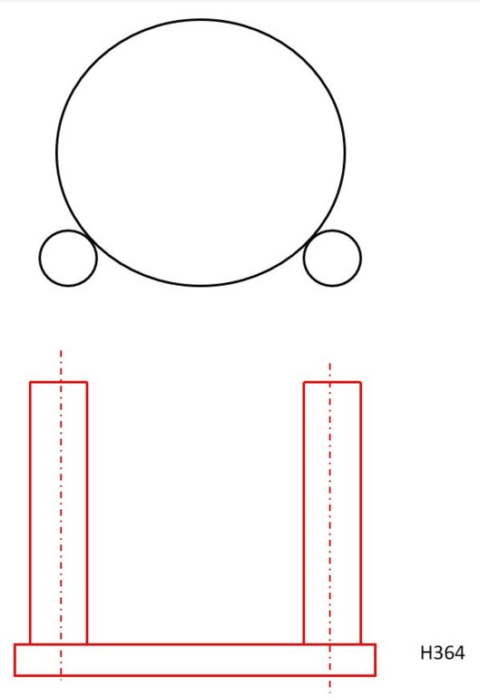

Blueadventures Posted May 10, 2019 Share Posted May 10, 2019 This is an image I saw a while back; may give an idea as you mount onto it outside and then push in. The large wheel will make pushing over grass etc easier. Cheers 1 Link to comment Share on other sites More sharing options...

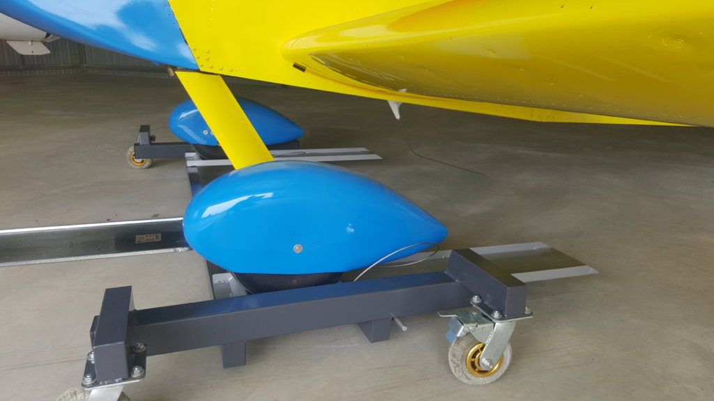

Jaba-who Posted May 12, 2019 Share Posted May 12, 2019 OK I’ve got a complex set that were made for me by an old engineer mate. I supplied the bits and a carton of beer and he built this fantastic set. Sorry haven’t got pics with me and the planes an hours drive away. I used them all the time when I shared a hangar with a EC120 helicopter. The Jabiru lived in one half of the hangar pushed in sideways from the apron. Probably way more than you want but I’ll tell you about them. Consists of two crab like devices for main wheels and just use a four castor wheeled simple metal dolly for the front wheel. The main wheel dollies were converted from car workshop versions bought from a local auto parts place but were then modified so they would fit under and not damage the spats. Consists basically of a horizontal frame holding a fixed roller and a movable roller. The movable one is moved closer to the fixed one by pumping a pedal of a hydraulic pump. You open them wide - roll it in place front and back of tyre, close the valve and pump away. The rollers come together and plane lifts off the ground about 50 mm. Repeat it on the other side. Put the front dolly in front of wheel. Lift the nose by the prop and push the dolly under by foot. All the wheels castor so it can be pushed in any direction. I can get some pics next week end if you are interested. 1 Link to comment Share on other sites More sharing options...
