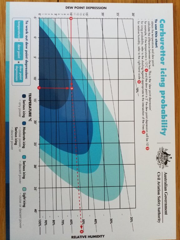

That would still leave you in almost prime carb ice territory. As facthunter said there are requirements for certification. The chart says serious icing ANY power for the dark blue, lycoming say somthing different.
