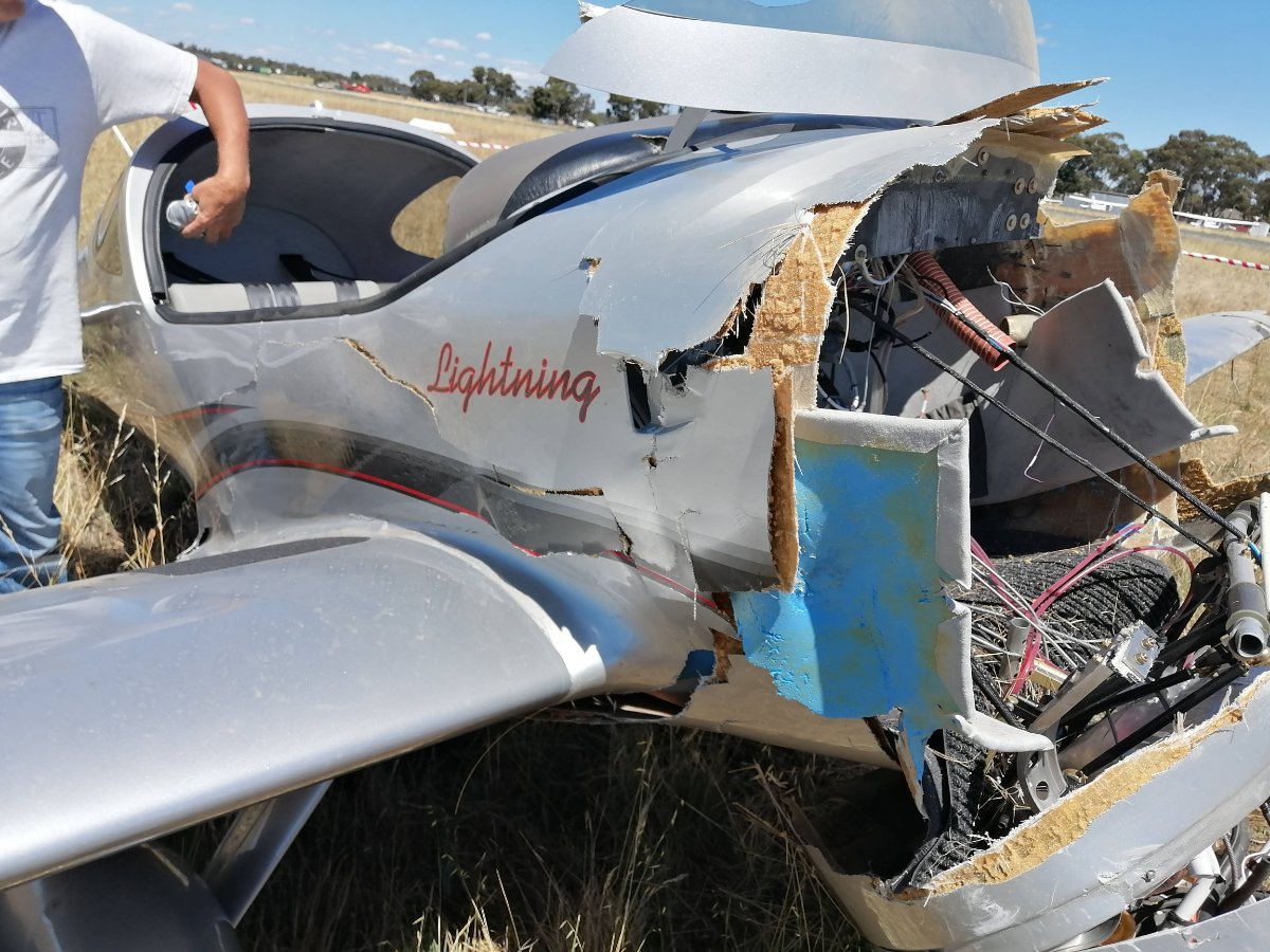

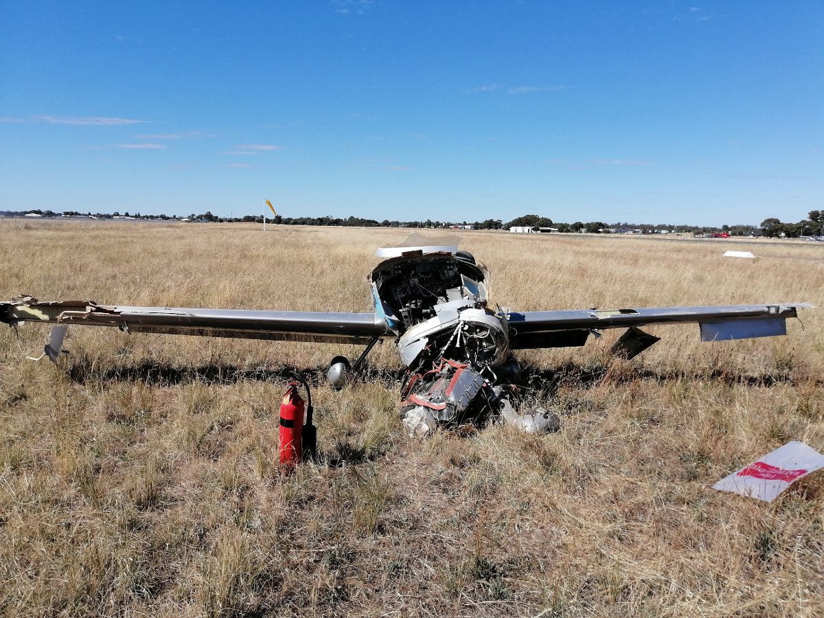

Thexder Posted February 7, 2022 Share Posted February 7, 2022 (edited) I witnessed the crash and it was not engine failure. It was pilot induced stall on take-off. Edited February 7, 2022 by Thexder Add image 7 Link to comment Share on other sites More sharing options...
kgwilson Posted February 7, 2022 Share Posted February 7, 2022 That explains the wreckage a lot. If it had been an engine failure so long as the pilot was competent and got the nose down quickly the aircraft would likely still be in one piece based on the flat terrain & dry grass. A stall at 100 feet or less is going to end in a pretty hard smack into the ground. The Lightning is pretty slippery & I assume WOT at stall. Not enough height to recover, but really good that the nose & engine absorbed a lot of the energy to allow the pilot to walk away. As they say any landing you can walk away from is a good landing. Of course it was not a great landing because the aeroplane can not be used again. 1 Link to comment Share on other sites More sharing options...
Thruster88 Posted February 7, 2022 Share Posted February 7, 2022 Just about the only rule that matters in simple day VFR recreational flying is dont stall the xxxxing aircraft. 3 2 Link to comment Share on other sites More sharing options...
Thexder Posted February 7, 2022 Share Posted February 7, 2022 (edited) 1 hour ago, kgwilson said: That explains the wreckage a lot. If it had been an engine failure so long as the pilot was competent and got the nose down quickly the aircraft would likely still be in one piece based on the flat terrain & dry grass. A stall at 100 feet or less is going to end in a pretty hard smack into the ground. The Lightning is pretty slippery & I assume WOT at stall. Not enough height to recover, but really good that the nose & engine absorbed a lot of the energy to allow the pilot to walk away. As they say any landing you can walk away from is a good landing. Of course it was not a great landing because the aeroplane can not be used again. That is a pretty perfect summary of what happened. Luckily it hit canopy up and the engine took the full force of the impact and thus he was able to walk away. Like I said, I witnessed it and spoke to the pilot afterward and this is what happened: - Quartering left tailwind on takeoff (~5 knots) - He said lots of right rudder used as left turning tendencies were taking him off the left side of the runway - He pulled back on the stick prematurely to get off the ground and avoid runway excursion - He mistakenly pulled back harder as the plane was buffeting near stalling (assumed a mistake in panic) - The plane wing rolled to the left turning him 180 degree as his wing scraped the ground and then his prop hit the ground Other factors that I can see are that this appears to be a near new plane to him, slippery laminar flow wing, poor choice of runway with the quartering left tail wind. Truly amazing he hopped out and walked away with but minor bruising on his shins.....very lucky man! Note: Jabiru engine was not a contributing factor and news media reporting 'engine stall' was laughable. Edited February 7, 2022 by Thexder spelling 2 3 Link to comment Share on other sites More sharing options...
