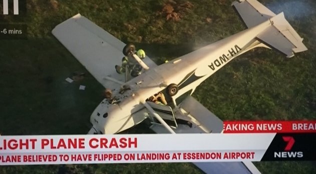

red750 Posted May 17 Share Posted May 17 Cessna 172 VH-WDA flew from Bacchus Marsh to Essendon, and touched down on runway 26 whereupon it flipped onto its roof. The pilot is reported to be uninjured. Link to comment Share on other sites More sharing options...

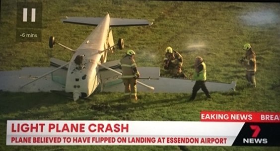

facthunter Posted May 17 Share Posted May 17 Looks as though the nosewheel has dug in in soft turf. What was it doing there? Very minor damage. Nev Link to comment Share on other sites More sharing options...
turboplanner Posted May 17 Share Posted May 17 He ran off the edge of the runway for some reason; I saw a curved track off the edge in the TV footage; perhaps a gust of wind, perhaps a brake lockup. Link to comment Share on other sites More sharing options...
red750 Posted May 17 Author Share Posted May 17 Yeah. Zoom in on Flightradar24 and you'll see the excursion to the left of the runway. 1 Link to comment Share on other sites More sharing options...

facthunter Posted May 18 Share Posted May 18 Could be a worn brake pad on one side. I've had it happen in a 182.. Nev 1 Link to comment Share on other sites More sharing options...

horsefeathers Posted May 20 Share Posted May 20 (edited) On 18/05/2023 at 10:09 AM, facthunter said: Could be a worn brake pad on one side. I've had it happen in a 182.. Nev An extremely close relative of mine had an almost identical problem (except for flipping) at Redcliffe a few years ago. Gun barrel straight approach and landing, and then without warning, her 172 took a sharp dive to the left. Ozrunways track of her landing looks almost identical to the above Flightradar track... bloody gremlins Edited May 20 by horsefeathers clarification 2 Link to comment Share on other sites More sharing options...
turboplanner Posted May 21 Share Posted May 21 14 hours ago, horsefeathers said: An extremely close relative of mine had an almost identical problem (except for flipping) at Redcliffe a few years ago. Gun barrel straight approach and landing, and then without warning, her 172 took a sharp dive to the left. Ozrunways track of her landing looks almost identical to the above Flightradar track... bloody gremlins Another possibility is a failure in the steering gear. Where the piper Cherokee system is direct, so steering starts as soon as you put your foot on the pedal, the 172 system incorporates springs. I find it slower and disconcerting. If the spring or linkage breaks on one side, the nose wheel will turn towards the other spring as it contracts. 1 1 2 Link to comment Share on other sites More sharing options...
