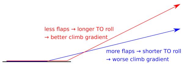

kasper Posted August 25, 2023 Share Posted August 25, 2023 On 15/08/2023 at 1:47 PM, Thruster88 said: How flaps work True BUT... If you have no flaps set and are in steady straight and level flight application of flap will initially create a significant increase in lift to 'pop' you over an imaginary treetop or fence ... the drag from the flaps that slows you down lags the lift in time of arrival so this is a just a blip because with fixed power and higher drag you will settle to a different airspeed and your climb gradient will return to that of your graph where you are at a lower climb gradient than than you could in theory have if flapless. Link to comment Share on other sites More sharing options...
facthunter Posted August 25, 2023 Share Posted August 25, 2023 The lift you get with flaps extended always results in a worse L/D ratio than the clean wing. Nev 1 Link to comment Share on other sites More sharing options...

Thruster88 Posted August 25, 2023 Share Posted August 25, 2023 I would think pitching to convert airspeed into short term obstacle clearing height gain would be just as effective as using flap, maybe more so? If we are concerned about obstacle clearance we would be climbing at best angle of climb speed Vx, normally about 1.3 times clean stall speed. Link to comment Share on other sites More sharing options...
