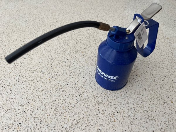

danny_galaga Posted November 7, 2023 Share Posted November 7, 2023 Some of you guys bleed your brakes from the bottom up with some sort of pump. You've sold me on the idea. So now I need to know exactly what you are using. Specifically. Not a general comment, but specifics. If it's a popular thing to do there must be tools for it. So tell me you got a Maxx 2000 Brake Wonder from Supercheap or whatever that I can put oil in and hook it up to the bleed nipple, job done. Don't tell me you found some old oil can of a special type that hasn't been made in 50 years, and then modified it 'just so' with home made machined parts etc. I just need to get cracking 🙂 1 Link to comment Share on other sites More sharing options...
rodgerc Posted November 7, 2023 Share Posted November 7, 2023 Here’s the one I used for the 3-1/2 minutes it takes to complete the job on Matco brakes. You’re welcome to borrow it to save $20 1 Link to comment Share on other sites More sharing options...

IBob Posted November 8, 2023 Share Posted November 8, 2023 I used a small cheap greenhouse pump sprayer with neoprene tube attached, but most of them leak at the screwon top, so test if buying. However, I like the idea of the pump oilcan above much better: the pumped up sprayer delivers the fluid at an uncertain rate, and needs to be shut off real quick at the end of the fill. Link to comment Share on other sites More sharing options...
