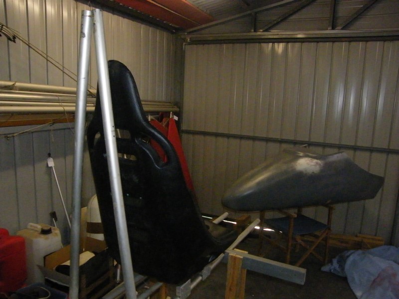

  10. Hi P47, I've just read your thread (no idea why I haven't before) and I have to congratulate you on your progress. Really nice work there. Now, it seems that you didn't get an answer to your question re the seat covers. Mine aren't quite the same but I bought the on e bay along with the matching rally seat. the seat is polypropylene and weighs 4 to 5 klg if memory serves me right.

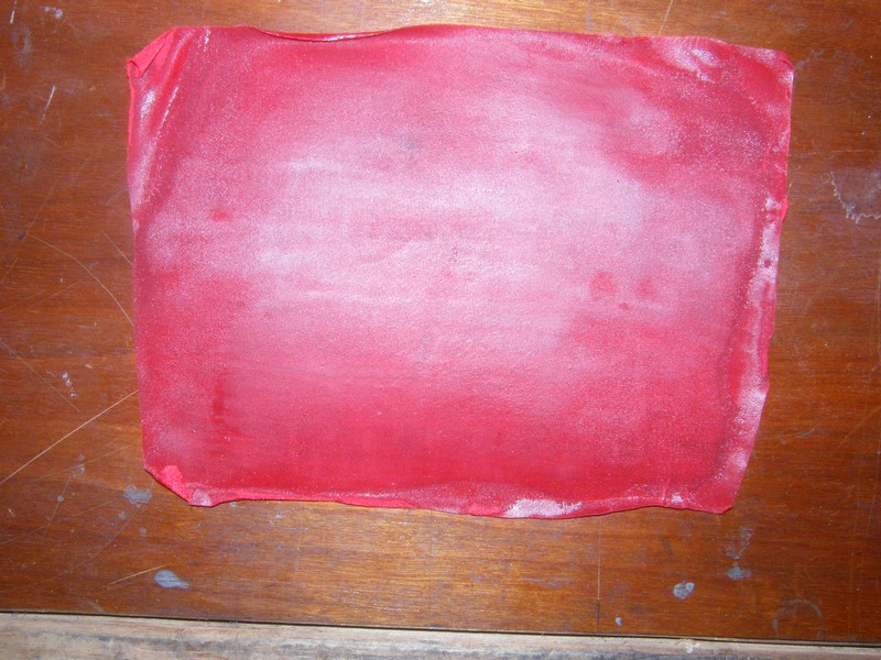

  11. Not a holiday by a long shot 80knts. Just had enough of overseas call centers so decided to change ip address. This in turn required a new phone number and email address. I think I've finally got it all working right so time will tell. Now, during the time I've been away, I tested the piece of Lycra/resin to breaking point. I found that the second coat of resin was not homogeneous with the first and on bending it 180degrees, it started to separate. Not good. Test piece 2 was initially coated with a thinned down resin, very lightly brushed on. Thinning resin isn't normally recommended. I let it cure for 3 hours and then brushed on another coat. My application wasn't very good but as you can see in the photograph, it appears to be a good bond. Although not recommended, spraying on the top coat would be the go over a large area. The finished piece is very strong (for a skin only, nothing structural) and should be impervious to UV rays, unlike Dacron which I'm about to replace. underside with no drip through resin. Had use flash as my workshop lighting isn't all that great. topside, showing poor brushmanship will wrap around just about all L/E shapes, I think. I can pull both side to touch (full circle) All comments recommended as usual.

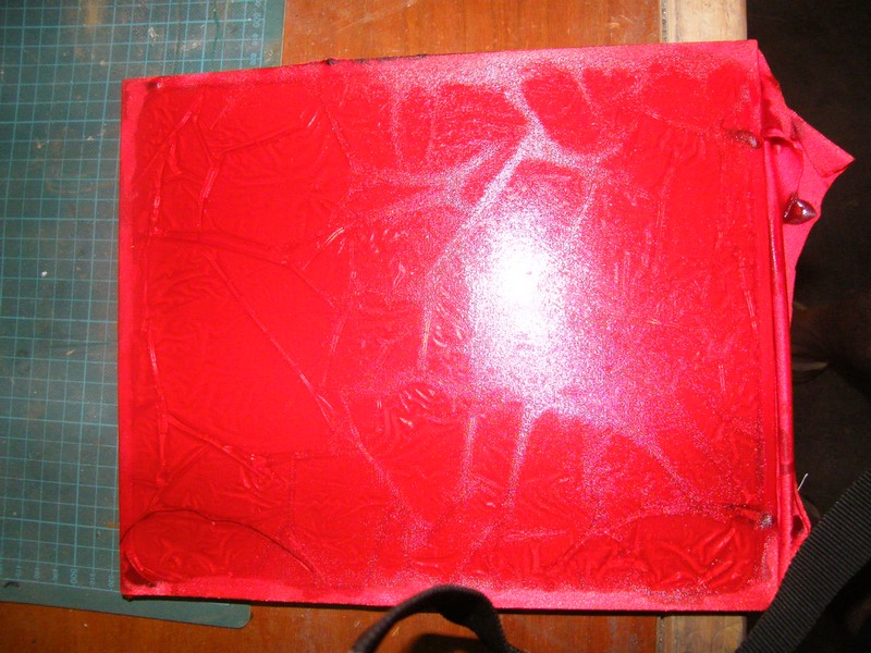

  14. I'm considering using Lycra/resin in lieu of Dacron for my Thruster. In this application, it would not be a 'structural' element. I think that it will be stiff enough not to distort under pressure changes but should retain a nice smooth surface to provide the lift needed to fly. I'm not sure about UV effects but with a very light coat of paint (colour matching only) it should be better than Dacron (IMO) My sample dried over night and is quite firm but not rigid. I pushed the resin too hard in application so the finished surface shows the Lycra weave and is fairly rough. I will apply a second coat today hoping to achieve a smooth surface and a bit more rigidity.

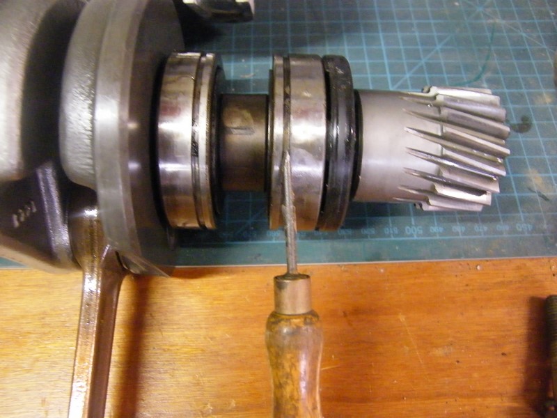

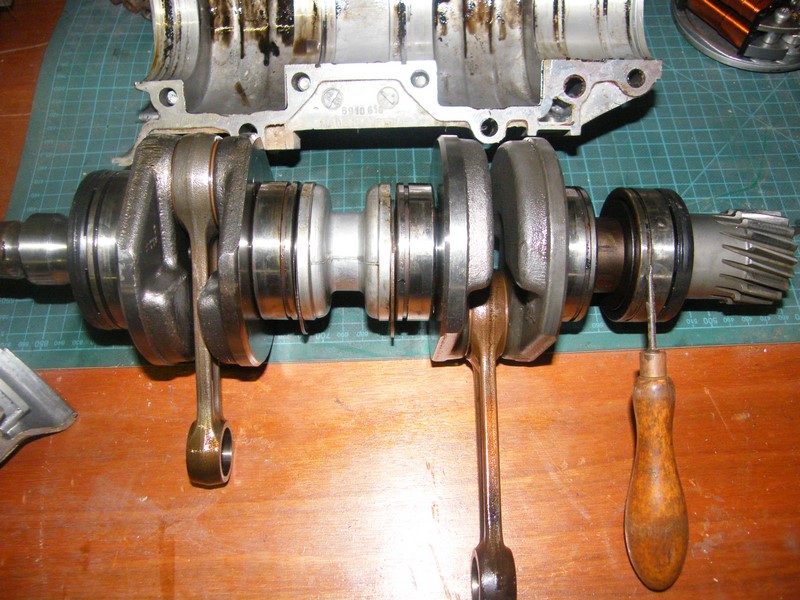

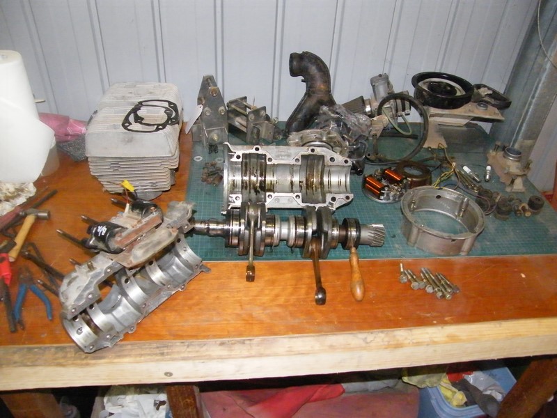

  15. OK, so here's how I did it. First, found an old photograph frame, cut some Lycra that I estimated would need about a 75% stretch to fit over the frame. Machined both sides to make a bag and then slipped that over the frame. Now, I realised that there might be problems with the thinned coat so I just covered the photo back card with clingfilm so that, if necessary, I had something to press on when working the resin in. Next I pulled the bag down to cover the bottom half of the frame and pinned it into place. Here are photos of the before and after applying the resin. You can see the clingfilm crinkled under the wet resin. I'm leaving it to dry and harden until tomorrow then I'l cut it off the frame for some bend tests. Now to get on with my engine which is a sorry picture. Note missing seals on all but one bearing. I think the remains of them are in the black sludge of the lower crank case. Any one ever refitted them, cause I need help.
  16. I'm about to do some test pieces to see how how the resin penetrates the Lycra. Also want to find out just how much to stretch it before lay-up. Can resin be thinned at all, if so what with? Thinking two coats, one thin, one as it comes.
