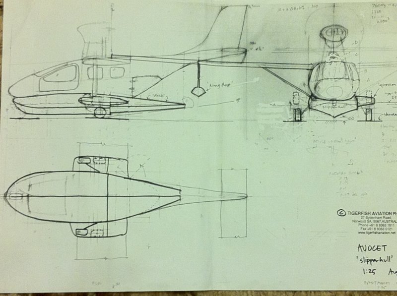

AVOCET Posted July 4, 2013 Author Share Posted July 4, 2013 get the engine off the top, and put 2 on the front like Jab have with their new prototype! The jabiru twins for the South African market , Stuck with one in Raa unless its VH experimental IDE have to put 2 on the wings otherwise its a complete new design Just as a note : to put the engine on the nose and have the load space in the back the design would have not much smaller than an Airvan It's already pretty big , it was originally designed for the Raa 760 MTOW , bad luck hay ? Link to comment Share on other sites More sharing options...

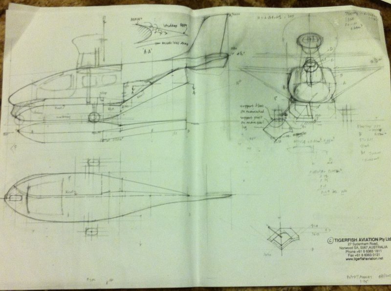

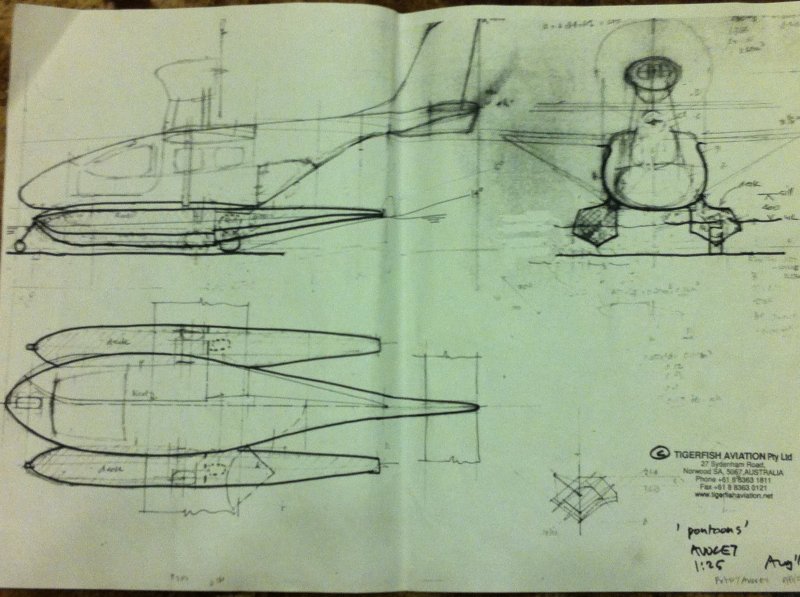

AVOCET Posted July 4, 2013 Author Share Posted July 4, 2013 I can see it making a great amphibian, as in you drawings. The engine is in the right place, the tail is up high out of the water , and the foward cabin design would lend itseft to gull wing type doors, similar to those on the Republic Seabee.....Maj... Check these out , already thinking about it , but I'm gona need help with an amphib . Any takers? 1 Link to comment Share on other sites More sharing options...
Jabiru7252 Posted July 4, 2013 Share Posted July 4, 2013 Who needs Autocad and similar (expensive) software - these drawings are like Leonardo DaVinci's!!! Artwork like that seen 300 plus years ago. Having said that, watching something evolve from simple wire frame models to fully rendered rotatable images on a PC is pretty dam cool. 2 Link to comment Share on other sites More sharing options...

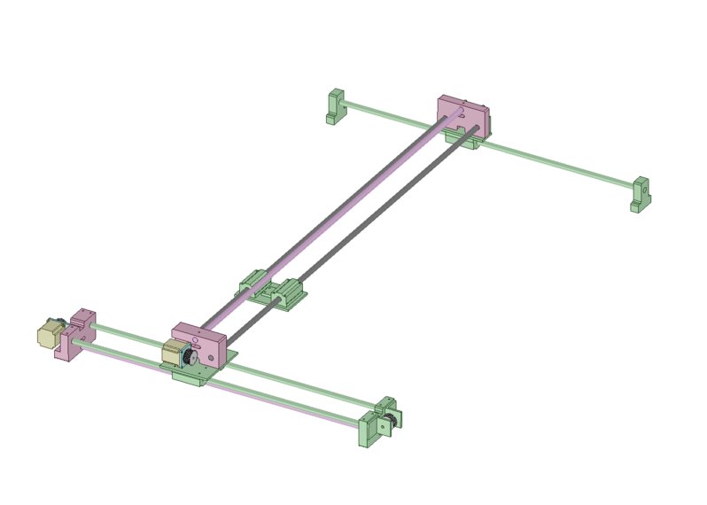

Kyle Communications Posted September 19, 2014 Share Posted September 19, 2014 Who needs Autocad and similar (expensive) software - these drawings are like Leonardo DaVinci's!!! Artwork like that seen 300 plus years ago. Having said that, watching something evolve from simple wire frame models to fully rendered rotatable images on a PC is pretty dam cool. Using some of this new 3D modelling software is pretty cool though. It makes designing stuff pretty easy and very cool especially when you can then print it with a 3D printer. This is the new XY mechanism for the new 3D printer we are making at work...its for our own in-house stuff and not for sale by us but its way cool its 1 metre in the X direction and 700 in the Y direction just have to finish the Z axis now. We have all the rods and linear bearings and end blocks made the stepper motors and drivers should be here on Monday..cant wait to start making it all work. The XY is belt driven and the Z is ballscrew Mark Link to comment Share on other sites More sharing options...
