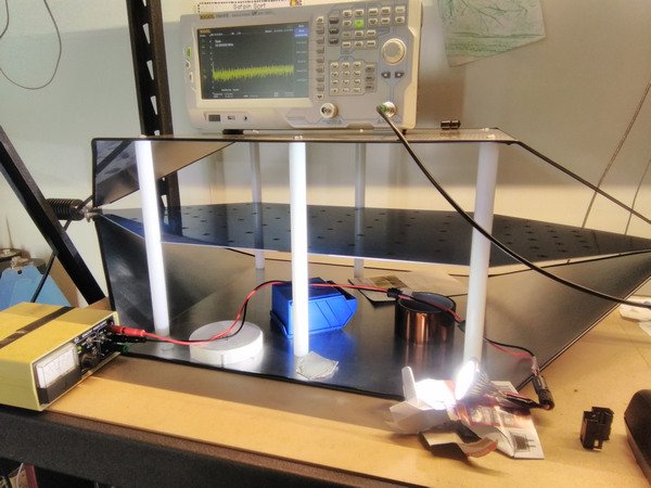

The lamps in question DO meet the standard. But for radio , that usually means still needs to be 10m away even if meets spec.
The radiated rubbish comes off the wires, not the lamp itself.
The EMF was approx 3uV/M. enough to open a VHF radio within 3 or 4meters of the wiring.  Its low, but not low enough.
Use of a single large ferrite slab cable clamp choke  killed it by x10.  Also, pairs of smaller clip on chokes also did the job, also. Probably what is mechanically easiest is suggested.  I will pull mine apart and investigate best  means of locating these chokes (as close to the lamp as possible).

pic -  (using the Rigol SA which is fine for this job... in my TBTC-3 TEM cell.)
