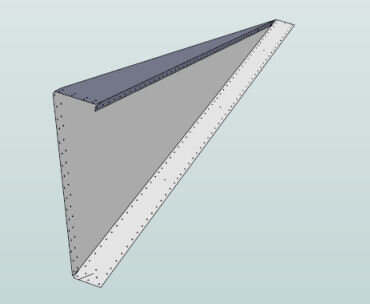

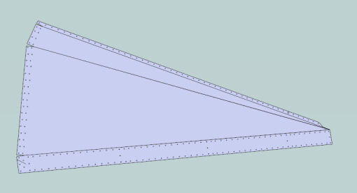

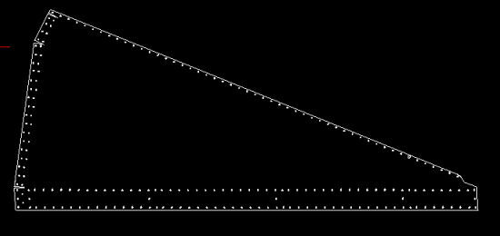

The XPB Stage 1 underway.
Love Sketchup, draw the part, flatten the part with just a couple of clicks, export to .dxf with another couple of clicks, and ready for cnc laser cutting....
Lets hope my aluminium sheet arrives soon so the file can be used ...
flattery.jpg.1e5bb4c179c9450ff84621dcfef1c092.jpg flattery2.jpg.10fa44d4163e826051599c6963f27542.jpg flattery3.jpg.44eab5e79e07644de0b556c854fac122.jpg
