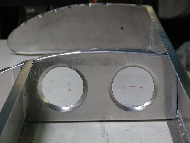

Just a quick question but do you "press" the ribs to shape them or are they just riveted ? I ask because ICP explained that they re-temper the aluminium by reheating and cooling to fairly precise temperatures when it has been folded or pressed.
All the alloy in the 701 is 6061-T6, which has already been tempered. To manufacture the ribs you cut out two wooden form blocks from wood, which include channels around the edge for relief bends. The rib blanks are screwed between the blocks, placed in a vice and belted with a rubber mallet to fold over the edges at 90 degrees to the rib. To stop crinkling in the bent over bit, you use various diameter rods/tubes (from screwdriver shank to 20mm) to whack in the relief bends, which then straightens out the bits between the reliefs nicely.
Finally the lightening holes are done with a fly cutter, placed between flanging dies and pressed with a car jack. Works like a charm but gets a bit wearing when you have multiples of the same part.

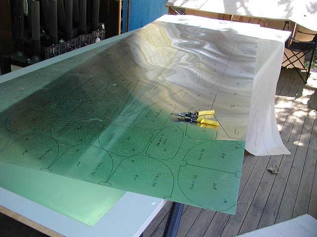

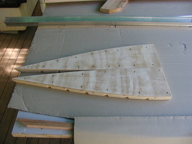

1. Laying out the bits:
1029470351_CH701buildingprocess01-sheetlayout.jpg.18f3dde2e14e0e687d8ee9c9eb71bbdc.jpg

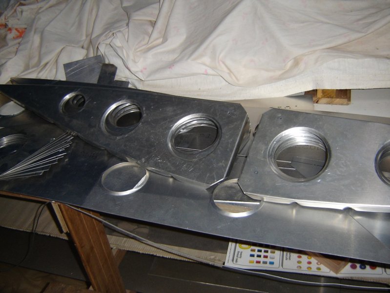

2. Wooden forms for wing rear ribs - see relief indentations. All formwork has a 3mm radius routed into it to prevent stress at the bend.

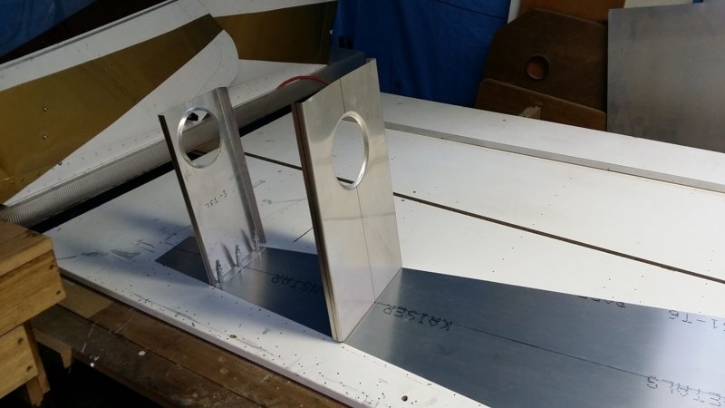

3. Formed rib (stabilizer)
231617490_CH701buildingprocess03-formedribs-stab.jpg.969a8a1741e6e1f90e3ed4e870131963.jpg

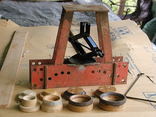

4. Equipment to flange the lightening holes - borrowed from a fellow builder here in Tas - thanks James!
816824447_CH701buildingprocess04-lighteningholeflangingtool.jpg.d926514ce005034a4754763ca9d88d40.jpg

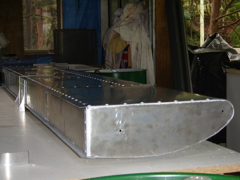

4. Stabilizer complete.
1960558334_CH701buildingprocess08-stabcomplete.jpg.02962fc0908a9599c2d3a0a7b3e4f4cd.jpg

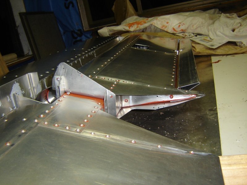

5. Stabilizer and elevator joined. Testing trim tab deflection.
1777422278_CH701buildingprocess09-stabandelevatorshowingtrimtab.jpg.c8d0b39a83de5315504ff7274d92c391.jpg

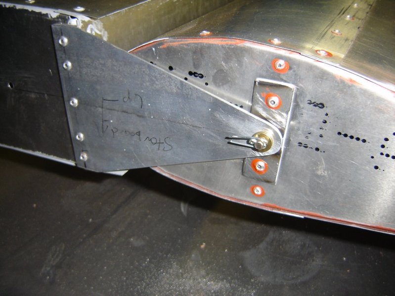

6. Close up of stab/elevator centre hinge point.
780503903_CH701buildingprocess10-stabandelevatorshowingcentrehingepoint.jpg.0d3551646b57ddaa22716c0d47218526.jpg

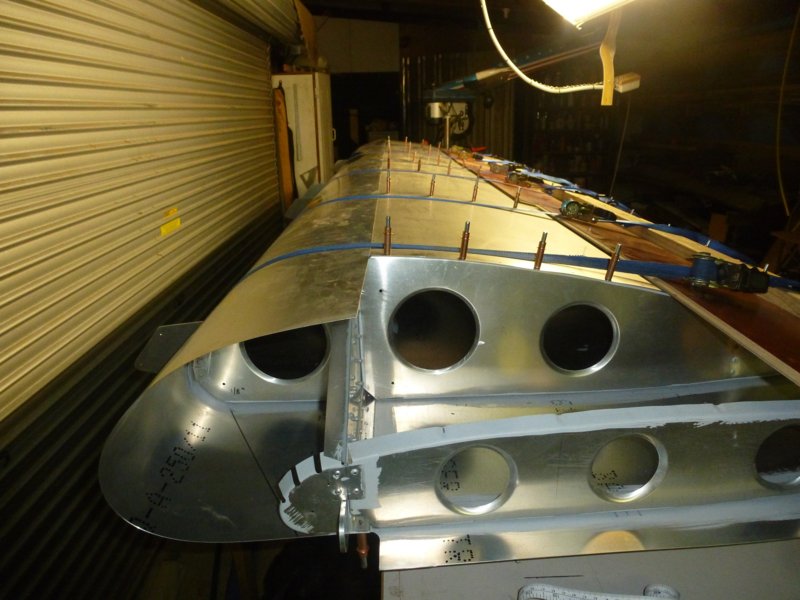

9. Bending nose skin over using ratchet straps.
571579964_CH701buildingprocess13-curvingnoseskin.jpg.909c0f56768f6825f6e54a10e1978fb7.jpg

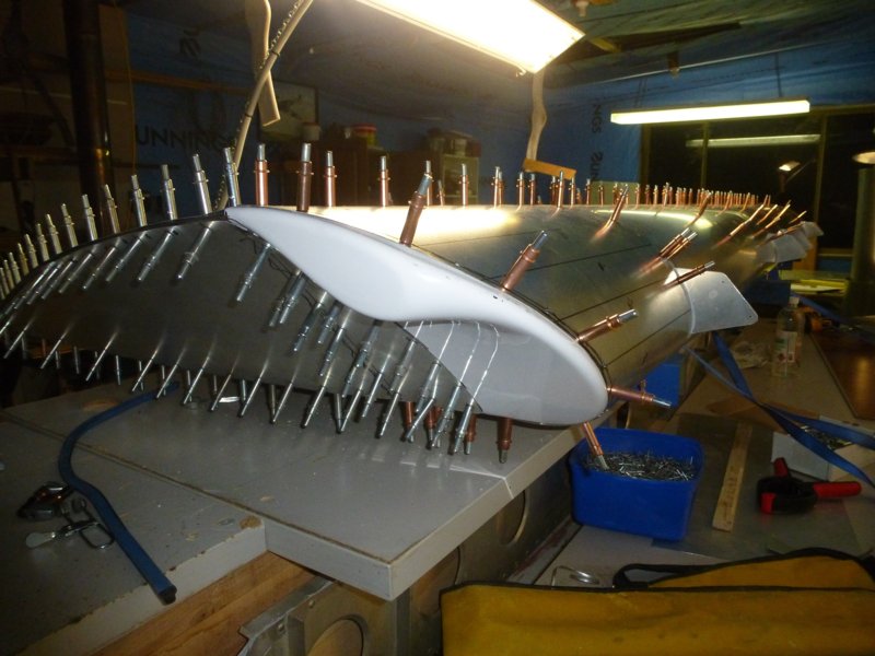

10. Wing tip installation.
1131577967_CH701buildingprocess14-installingwingtip.jpg.cc1f07e37ce99364558a0f3871c1527b.jpg

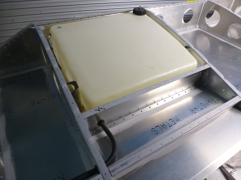

11. Installing the Savannah wing tank.
815020904_CH701buildingprocess15-wingtankinstallation.jpg.bacc8dc2a40a6867795f841e09d9fb85.jpg

.......Finally the lightening holes are done with a fly cutter, placed between flanging dies and pressed with a car jack. Works like a charm but gets a bit wearing when you have multiples of the same part.
.....4. Equipment to flange the lightening holes - borrowed from a fellow builder here in Tas - thanks James!
[ATTACH=full]46944[/ATTACH]
I can imagine winding the car jack up and down a hundred times or so would have been a bit wearing ...

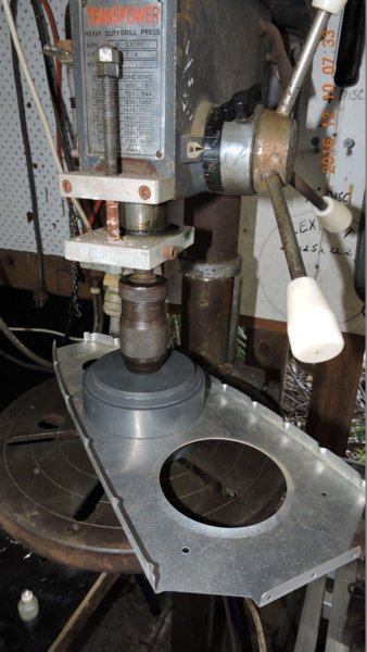

I guess it's a bit frustratingly late to mention it for your current build, but it doesn't actually take much force to press the flange around the lightening hole, so next time you don't really need a jack or a powerful shop press. On mine I use forming dies that are virtually identical to your friend's, and I just bump them together using the quill of the drill press. It's pretty much effortless and each one takes about two seconds -
Terrific craftsmanship once again Marty, and another great set of scratch build photos, thanks for posting great-job.gif.1c4420e129f3a1333752be4c1aec8583.gif
Thanks HITC. I didn't know about the drill press trick - wish I had!!
