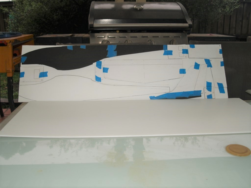

old man emu Posted May 5, 2020 Author Share Posted May 5, 2020 Where did you get the templates to download? Open the Youtube file and you will find a link to the plans in the info underneath. You can download the plans in A3 or A4 size. Four sheets for A4 and two for A3. I'm using the bigger A3 size and it cost me 40 cents at Officer Works to get the two sheets printed. I'm using 5 mm corflute from Bunnings @ $9 per sheet (99 x 600). You need two sheets because the plans don't have a drawing for the belly and top skins. One sheet will give you the wings and fuselage sides and bulkbeads. The other sheet is needed for belly and top skins and for wing spars. The video shows the use of a balsa strip to strengthen main spar. I'm going to use a bamboo garden stake. No use wasting good balsa on a lawn dart! Depron from Bunnings is about $16 per sheet. I scored some Depron, so I think I'll use the A4 plans, which I printed myself, to make a silhouette glider for my grandson. I'll use corflute for the wings and tailplane. Instead of hauling out my box of balsa, I used some 3 mm ply for bulkhead A and for the dihedral brace. I also made the tail skid from balsa. I'll probably dig out some 5 mm ply for the landing gear block. If you have a bandsaw or scoll saw, it makes it easier to cut out the shapes. You'll need some sticky tape to seal the edges of the fin, tailplane and possibly front of the fuselage after you cut them, otherwise they will trap the oncoming air. Also, if using corflute, cut any vertical bulkhead with the tubes of the corflute running top to bottom. That makes the piece more crush resistant due to the strength of a column. 1 Link to post Share on other sites

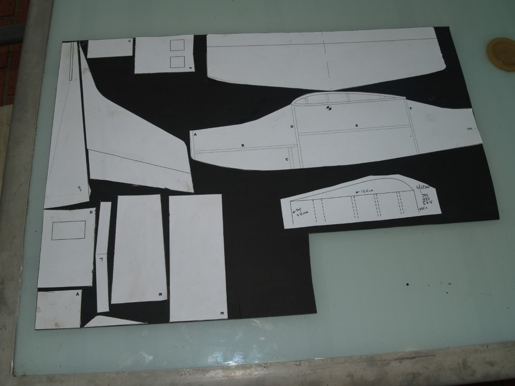

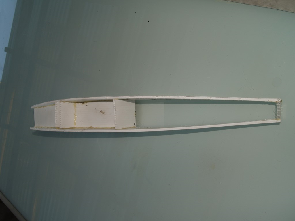

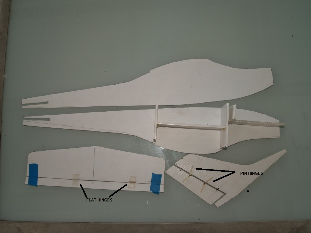

old man emu Posted May 7, 2020 Author Share Posted May 7, 2020 Someone dared ask for me to update this build. I've cut the fuselage sides; rudder/fin and tailpane/elevator. I've found a small prop for the brushed motor. I just need to make a tight fit for the prop on the motor's output shaft. I was digging through my 30-year-old bits'n'pieces box and found some pin hinges for the rudder, and some flat hinges for the elevator. The bulkheads and floors have been glued together with hot glue. Since I'm spending the day home-schooling my grandson, I'm not moving forward with the plane construction. However, he and I have nearly finished a puppet of the character in his English writing work. I'm not impressed with the lack of information that the school has given in relation to teaching arithmetic. If I knew what the leanring path was that he had to travel I'd be more at ease with teaching him. Here's where I'm up to with the plane: 5 Link to post Share on other sites

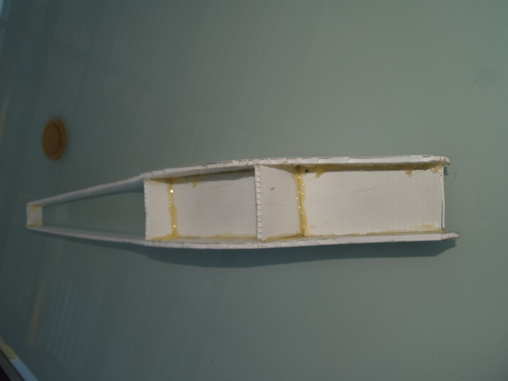

old man emu Posted May 10, 2020 Author Share Posted May 10, 2020 (edited) Come on, it should have had its first crash by now! Festina lente, my son. Festina lente. Rome wasn't burnt in a day. I got this done today. That hot glue makes great filets. Pylon 500 said, "I'm assuming that the 'airfoil' shape on the top of the cabin is later cut off, and the one piece wing sat on the now flat top?" I had a look at the plan and the fuselage and realised that you are correct. I'll cut the aerofoil shaped bit off along a line from the rear cabin bulkhead to the front one. The wing will then rest on the top of the fuselage sides. The wings should be made today (Monday 11/5/20) Edited May 10, 2020 by old man emu 3 Link to post Share on other sites
