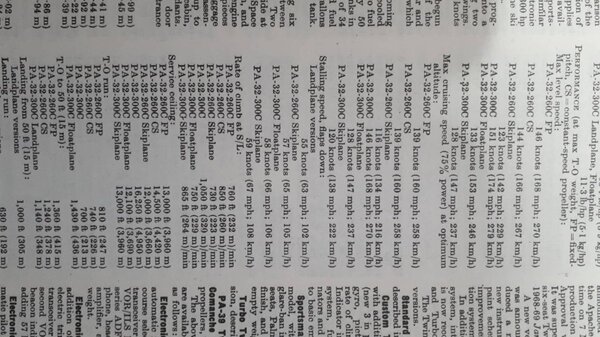

Thruster88 Posted July 3, 2022 Share Posted July 3, 2022 (edited) 1 hour ago, Paul davenport said: And still no real world figures from a j230 owner with a CSU prop , all speculation and guess work , which maybe correct but until it’s actually confirmed speculation nonetheless The performance gains mentioned in your original post are BS. There is nothing special about a j230, it is an aircraft that will cruise at 120 knots just like a current model piper archer or cessna 172. These two aircraft have always had fixed pitch props. Would they go faster with a constant speed, no because they can all ready cruise at 55%, 65% or 75% power with their fixed pitch props. They have power charts in the POH to show rpm to use at various altitudes to achieve this. Would the takeoff performance increase, yes but only by about 5-10% based on data from aircraft that have a fixed or constant speed option propeller. All aircraft fly in the same fluid and are subject to the same physical laws. Flywheel retention is an issue for the jab engine, do you want to fit a different propeller that may increase the risk? Edited July 3, 2022 by Thruster88 1 Link to comment Share on other sites More sharing options...
