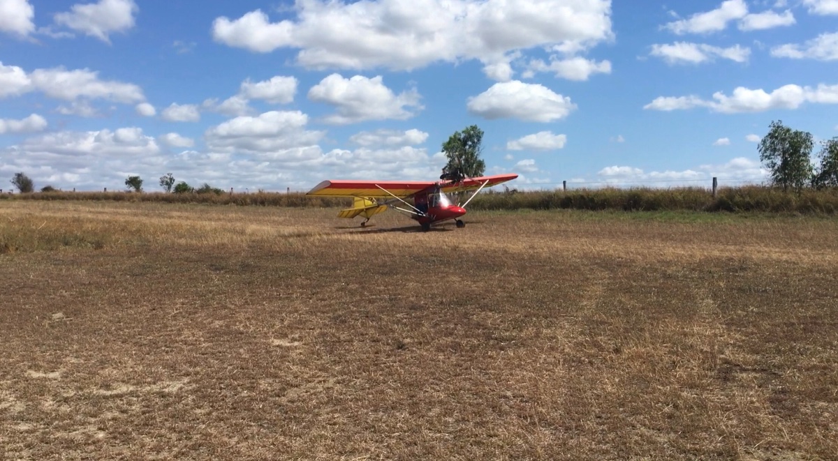

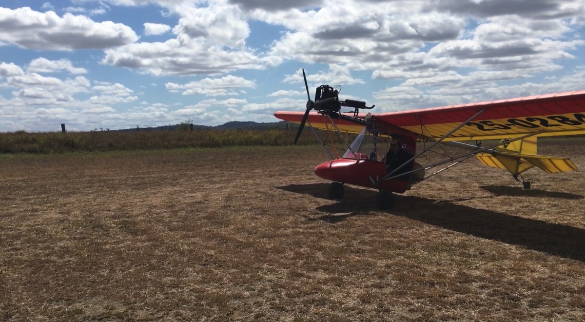

jackc Posted September 26, 2021 Share Posted September 26, 2021 Ferry pilot delivering mine last week 🙂 4 Link to comment Share on other sites More sharing options...
Flightrite Posted September 26, 2021 Share Posted September 26, 2021 Look at all that lovely open sky there, I can almost smell the 'freedom'😉 1 Link to comment Share on other sites More sharing options...
jackc Posted September 26, 2021 Share Posted September 26, 2021 20 minutes ago, Flightrite said: Look at all that lovely open sky there, I can almost smell the 'freedom'😉 Sure will be in ‘NO lockdown’ Queensland 🙂 2 Link to comment Share on other sites More sharing options...
