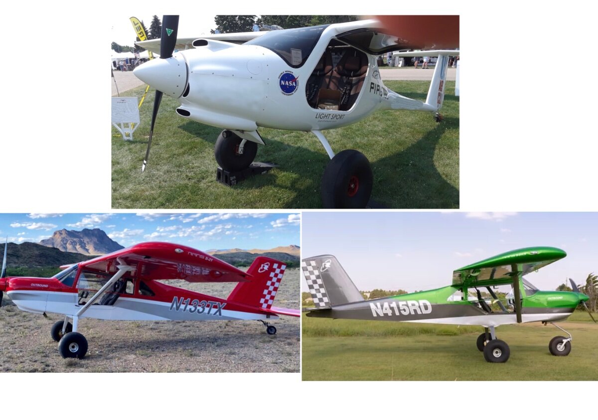

Reasons to go tail wheel reducing order of importance in my humble estimation…
No nose wheel to worry about during landings on bush strip with concerns for
. First contact with the ground and how big the bumps and ruts are.
. First contact with ground by nose wheel or tail wheel. Definitely tail wheel wins big here. It’s in the back and can just harmlessly be bumped a bit into the air by a rabbit hole etc that may  take the nose wheel right off. Tail wheel still needs protecting of course. Slammed into the ground and stuff can break.
. Crosswind. Nice to be able to plant the aircraft nicely on the ground where the aircraft isn’t easily thrown back into the air. A nose wheel is after rears make contact with the ground going to be gently skimming the ground or still not in contact. Easily thrown up into the air on the necessarily faster crosswind landing. I, again do this occasionally  at the hilltop and being slow and back in the air I’m sometimes either at add throttle or keep off ailerons and mostly ruder so a wing isn’t dragged downward by the long flaperon. Tail wheel at this point is firmly in contact with the ground and really not a factor.
. Braking. I’m doing this almost daily and really dislike it twice. First time is I settle the nose wheel down. I have an uphill and downhill component. If I’m late I have to try to settle the nose wheel gently  then eventually brake while going downhill. Just not a factor in a tail wheel. Second is again being a little late and being forced to use more brake than you’d like because the fence is not that far away. Again, tail wheel wins hugely here. Just brake as hard as you like with little left and right corrections as needed to keep the nose very interested in the Center line and back off if the tails coming up. Worst case it’s started to go to crap and you apply power and correct or  very worst case go around.
. Reduced drag and increased speed and fuel efficiency.
. it looks cool. I admit to liking the tail dragger look with the big tundra tyres. At OSH Kosh 2021 this Pipistrel Virus tail wheel  was my pick of all aircraft at the show just based on refinement and efficiency in flight followed by the Rans S21 for its STOL and high speed cruise capabilities.
pics below are the Pipistrel Virus that looks heaps better in tail wheel and RANS S21 which I think looks cool either tricycle or tail and those big tundra tyres in tricycle you’d think would handle anything. Makes me want to assemble tricycle first…. We will see.
