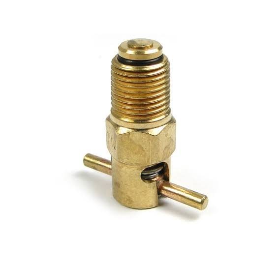

Just about every light aircraft uses the same system. Orings are almost totally reliable when used in a fixed recess like a propeller seal. The used in fuel drains rely on the Oring not breaking to remain in place.

Curtis drain valves work well & can be locked open & fuel will drain quickly from them so it is pretty hard not to notice. I replace the Oring if I ever notice a drip on the bottom of the valve after a fuel check which I do before the first flight of the day & after every refuel. I have replaced a couple over time.
Jabirus do not use Curtis brass drain valves.

"O" rings are notorious for having pieces cut out of them when being "ported.". The "other" metal on metal type is able to be pushed off it's closed position by a drain pipe and better/essential where the wings are well above  normal reach. Both rely on a spring to close off. Leaving the fuel cap unsealed with a bladder tank is worse.   Nev

I carry two spare 'o' rings in my kit and a spare whole curtis valve when on trips away.  as a failed vale can muck up trip and flight plans.  So if discovered after fuel drain I can do a refit of an 'o' ring and no noticeable delay.  no weight or cost involved as light and cheap.

The reason they get chopped up is some swell and the fuel (petrol) is not a lubricant as diesel is.  A Plain  threaded Bung is OK as a quick fix to get you home. No one could fault that. Nev
I can't remember, but isn't there a specific O Ring material for fuel and similar applications, with a different colour?
My Davis fuel drain is at the bottom of the fuselage and fuel comes from the tank via a tap to the drain. That was used for two reasons. 1 The fuel line from the tank to the drain goes between the pilots legs, so a tap makes it safer. 2 The davis drains are known to leak so  tap prevents the tank from being drained during flight.
