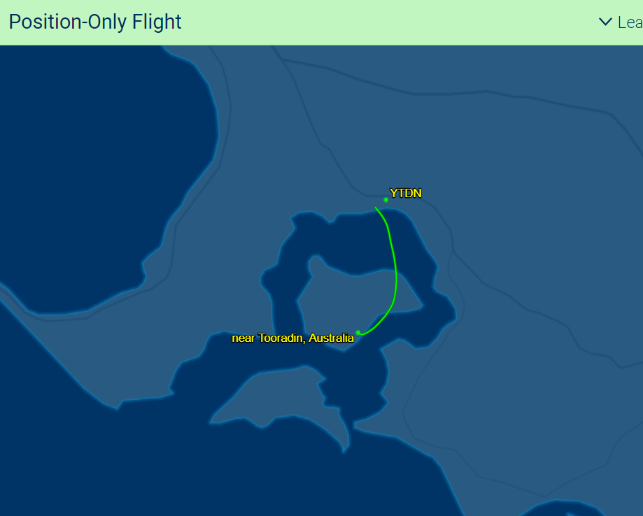

red750 Posted January 21, 2023 Share Posted January 21, 2023 A Vans RV-9A flipped on landing at French Island on 21 Jan 2023. The pilot was flown by helicopter to Royal Melbourne Hospital with undefined injuries. It is believed the aircraft departed from Tooradin. 1 Link to comment Share on other sites More sharing options...

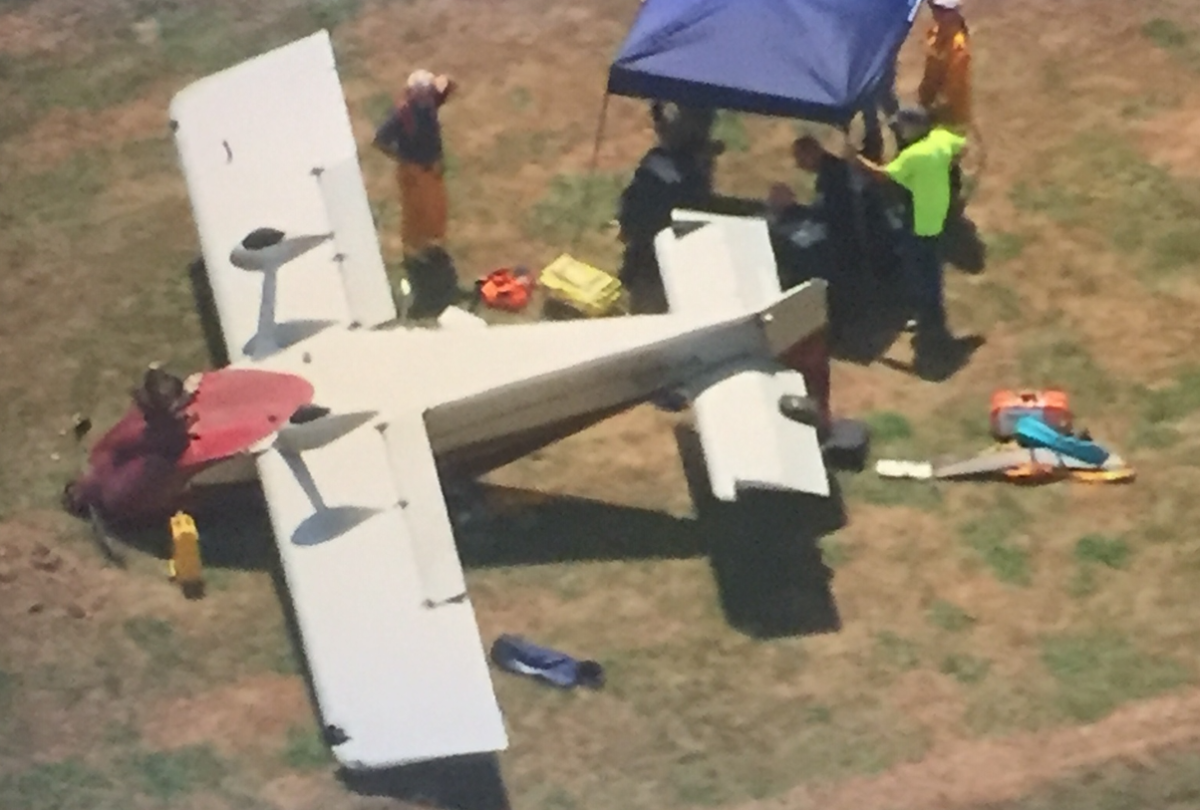

turboplanner Posted January 21, 2023 Share Posted January 21, 2023 The nosewheel looked to be against the floor. 1 Link to comment Share on other sites More sharing options...
Mike Gearon Posted January 21, 2023 Share Posted January 21, 2023 Pilot is okay. Passenger had a few injuries. Airlifted to hospital. Passenger is now fine. Strong variable tail wind and yes the nose collapsed. If that nose wheel assembly was stronger it would have been a different story. Apparently this is an RV problem. 1 1 2 Link to comment Share on other sites More sharing options...
red750 Posted January 21, 2023 Author Share Posted January 21, 2023 From Channel 2 News 1 Link to comment Share on other sites More sharing options...

Mike Gearon Posted January 21, 2023 Share Posted January 21, 2023 Could have been any one of us and he’s beat up over his friend being hurt. He did a great job pulling the passenger from the aircraft. The good part was when his friend called from hospital and was okay. Well, very okay. They must have started using the good drugs. While I wasn’t impressed with the Vans nose gear (rans S21 is much thicker) the steel tube (roll bar?) above the screen looked like it could have taken a lot more abuse just fine. 6 1 Link to comment Share on other sites More sharing options...
facthunter Posted January 21, 2023 Share Posted January 21, 2023 IF you make the nosewheel stronger the bulkhead will break. ALL nosewheels are relatively weak and not there for extreme loads. It's obviously gone over at a low speed. You'd have to be there to know what the circumstances were. Nev 1 4 Link to comment Share on other sites More sharing options...

facthunter Posted January 22, 2023 Share Posted January 22, 2023 A tail wind can lift the tail at zero speed if it's gusty. The plane appears to be undamaged apart from the nose strut. Nev Link to comment Share on other sites More sharing options...
onetrack Posted January 22, 2023 Share Posted January 22, 2023 What facthunter is saying is that as the speed dropped off, there was only just enough energy left for it to flip over. A flip over at high speed would have crushed a lot more components, and bent or fractured the fuselage. 1 Link to comment Share on other sites More sharing options...
