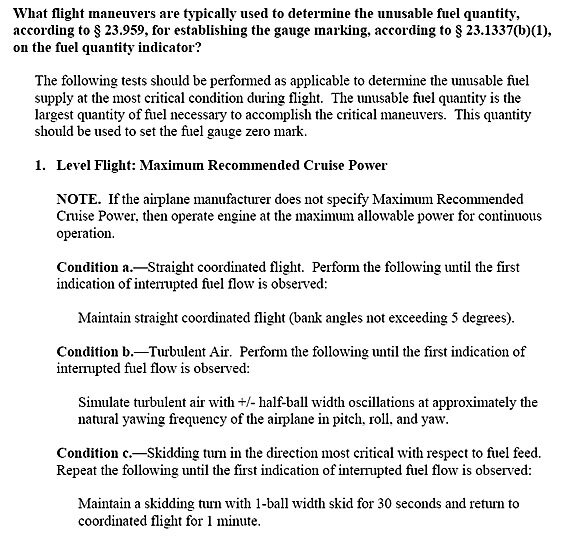

Dafydd Llewellyn Posted August 19, 2014 Share Posted August 19, 2014 Are Jabiru wing tanks of constant chord, or do they taper? In level flight the wing will slope down a little at the back, so if the aft edge of the tank tapers up towards the wingtip, it would take significant out-of-balance flight to prevent fuel from reaching the outlet. If they were tapered, the total fuel capacity would be reduced. If you make a totally foolproof aircraft, only a fool will fly it. If you comprehend that fuel will flow from the wing tank to the collector tank only if the wing tank is higher - which is not really all that enormous a concept, surely? Then it would follow that it's not a bad idea to regularly raise each wingtip in turn a little, when you are getting low on fuel. So the philosophy of the consumer society that it's always somebody else's fault and products should be such that no thought at all is needed to operate them, will ultimately result in products that are so limited in capability, in order to be foolproof, that nobody will want to use them. I've just been watching Attenborough explaining that the dominance of the human race is due to the use of intelligence. If you want to gain an advantage, it pays to use your intelligence. The penalty for stupidity, in nature, is death. 3 Link to comment Share on other sites More sharing options...

Guest Andys@coffs Posted August 20, 2014 Share Posted August 20, 2014 The relatively low amount of dihedral on jabs leads to another issue with parking. If you park so that one wing is lower than the other (easy to do, doesn't take much of a slope) and the tanks are full then the high side will drain to the low side and overboard, in my case from the filler cap. (yeah I recon I need to replace the O rings) Almost worth having one of those cheap plastic spirit levels so that you can put it across the wings and turn the plane until the wings are relatively level....Alternately if you have wing tank taps you can turn them off....but then run the risk of forgetting to turn them on! Link to comment Share on other sites More sharing options...
Dafydd Llewellyn Posted August 20, 2014 Share Posted August 20, 2014 The relatively low amount of dihedral on jabs leads to another issue with parking. If you park so that one wing is lower than the other (easy to do, doesn't take much of a slope) and the tanks are full then the high side will drain to the low side and overboard, in my case from the filler cap. (yeah I recon I need to replace the O rings)Almost worth having one of those cheap plastic spirit levels so that you can put it across the wings and turn the plane until the wings are relatively level....Alternately if you have wing tank taps you can turn them off....but then run the risk of forgetting to turn them on! That also happened on my PA 28 - and it had plenty of dihedral, and short tanks. It's not really an issue of dihedral; it will happen in any aircraft unless the fuel shut-off valve isolates the tanks when in the "off" position - and many of them don't. The alternative way to stop that is to use a "cross-over" vent system; but you end up with a multitude of drain points to check every morning, because the low points in the vent plumbing must have drains to remove any water that may collect there. Link to comment Share on other sites More sharing options...

geoffreywh Posted August 20, 2014 Share Posted August 20, 2014 some people are not getting the intended irony in my post. I said that the 230 MUST have had at least 15 ltrs left (otherwise he would have been operating illegally) -- You should have 45 minutes reserve in the tank when you land...... For all I know he had none, very little or lots, probably NOT exactly 15 litres!!! Link to comment Share on other sites More sharing options...
SDQDI Posted August 20, 2014 Share Posted August 20, 2014 some people are not getting the intended irony in my post. I said that the 230 MUST have had at least 15 ltrs left (otherwise he would have been operating illegally) -- You should have 45 minutes reserve in the tank when you land...... For all I know he had none, very little or lots, probably NOT exactly 15 litres!!! Don't let the facts get in the way of a good story Geoffrey:wink: 1 1 Link to comment Share on other sites More sharing options...
