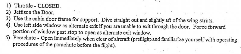

kaz3g Posted January 16, 2016 Share Posted January 16, 2016 [ATTACH=full]40761[/ATTACH] I knew there was something I'd forgotten to include in my run up checks...? Kaz Link to comment Share on other sites More sharing options...
