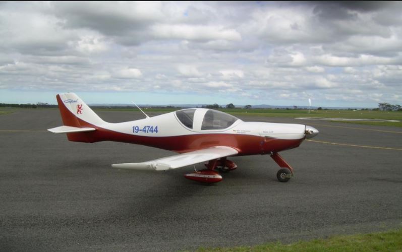

red750 Posted November 27, 2016 Share Posted November 27, 2016 This looks like the plane involved, rego ending 44 recently in Aviation Advertiser. 1 Link to comment Share on other sites More sharing options...
Oscar Posted November 27, 2016 Share Posted November 27, 2016 Geoff: this may well display my lack of experience of power flying, but at 3 metres, I am putting the nose down to gain airspeed... 1 Link to comment Share on other sites More sharing options...
Piet Fil Posted November 27, 2016 Share Posted November 27, 2016 From the Aviation Advertiser ad ... It had a Rotax 100hp engine with around 130hrs on it. Link to comment Share on other sites More sharing options...
